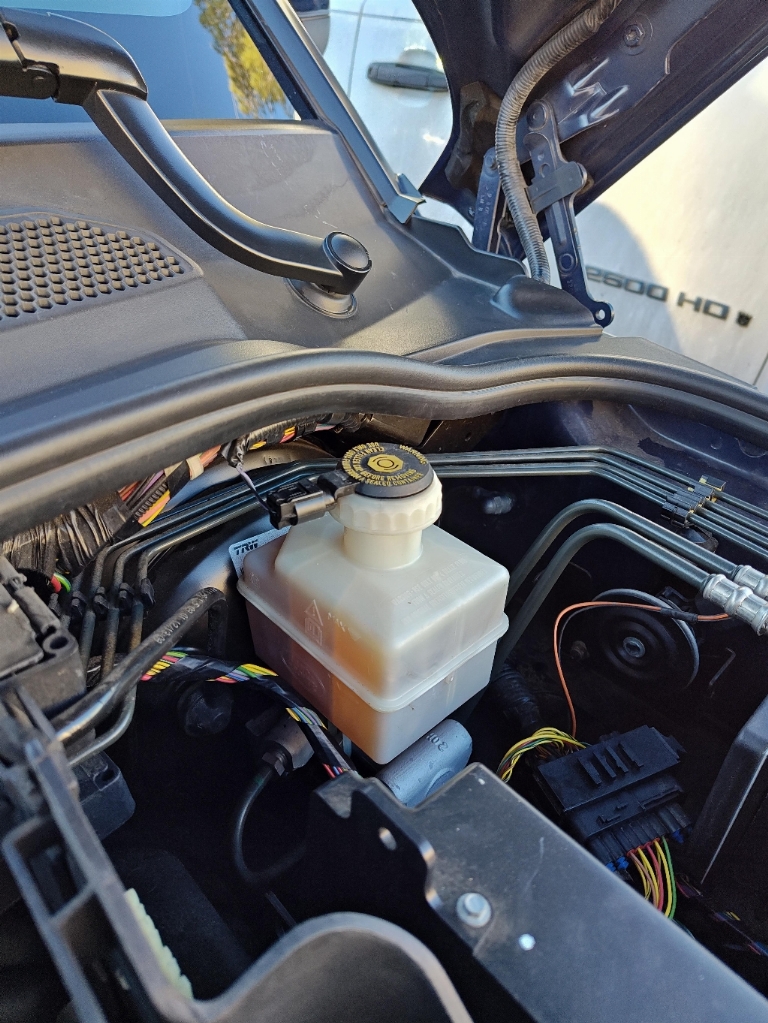

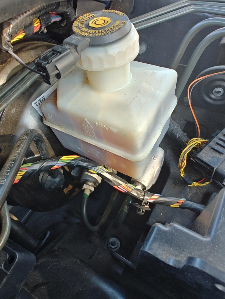

I had a bunch of work done to my LR4 and one ask was to flush the brake fluid. It seems like they did flush the brakes, but in the pic below doesn't it look suspect where the front compartment looks like it has fresh fluid, the middle is fair enough and then the back looks pretty dirty? I called them and they will look at it. I also noticed my front diff breather is missing and I definitely need that. I'm glad I did the front xover because I would have been fording water w/out a front diff breather. Any thoughts on the color of brake fluid in the reservoir?

These reservoirs have three "compartments" . One is for the hydraulic clutch, for vehicles with the manual transmissions.
They probably didn't suck all the old fluid out of the reservoir before doing the flush.

Yeah, that sound right that they probably didn't remove the fluid. The front-end guy said that is how they are supposed to do it. Remove the fluid, add fluid and then bleed with a vacuum bleeder.

I took it back to them and they got more of the dirty fluid out. It looks better.
