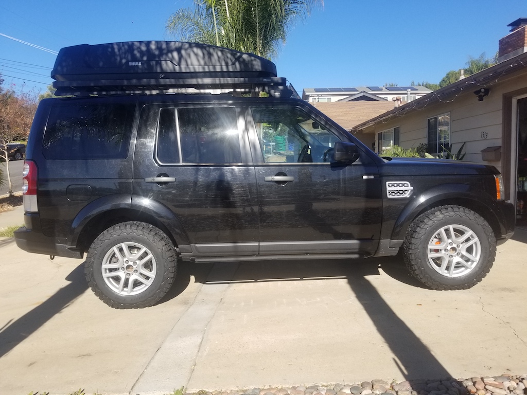

That's how I understood it too. However, upon installing all the hardware I quickly noticed that the LR4 has a HUGE front caliper that doesn't mount up to the brackets. So I'm just referring to the fronts. The 5.0L pads don't fit the 4.0L or 2.7L brackets, they're too big. Looks like the LR3 v6 and v8 pads are interchangeable. The LR3 calipers have a different part number from the LR4. I ended up ordering the LR3 calipers and pads that are compatible with the 2.7 tdv6.
Hopefully that'll do it.

Here's a sneak preview of what I'm doing.
open
https://drive.google.com/open?id=1dZ2DxzDRmxT7GkmTddf5VginWmWaAUEx
djkaosone
'11 LR4 HSE LUX 5.0L V8
Oct 26, 2015
1,085
750
SoCal
open
Hopefully that shows up for some closure to this. Project is successful and complete.
