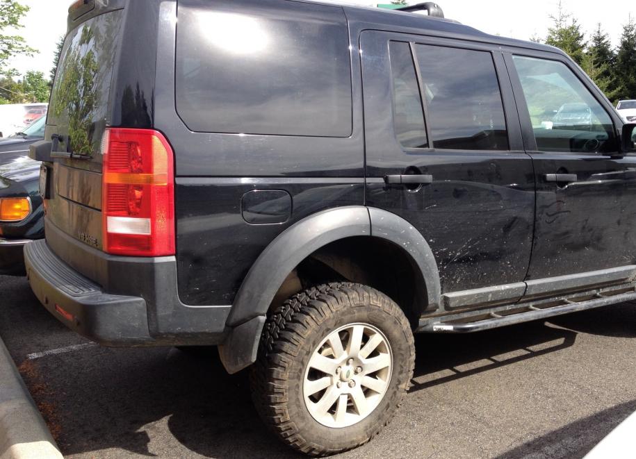

pics of the issue
I snapped a photo of my LR3 at the Dealership parking lot. Clearly the back end is WAY high. Considering there is one new sensor in the front psx side and one new wiring overlay in the front driver's side...I think there is some kind of (lack of) communication issue with the EAS Control Module, or a CANBUS issue.
Has anyone experienced this? Any ideas on how to get the IDS talking to the EAS CM again and/or how to get proper sensor range values into the EAS CM so that it will calibrate?
Thanks much! I've been Rover-less for 11 days and I'm having withdrawls.

Mack73
Sep 9, 2009
188
dang Erek, still can't get it fixed :(
So definitely no more powerline ........ ha

J....I will NEVER stop doing Powerline Trail; I love it. ...and this was a gradual thing, not a one-time collision thing.
Hey...too bad I can't access this uber-extended height on command! Look at that! Gotta be 15" of clearance back there! I could put 35's on that ***** at that height! Hahahahahah....
I think we're getting closer to fixing this. All the hardware is replaced and it's just a comm issue now, but yeah being Roverless in Seattle sucks. Today would've been a great day to detail. :(
