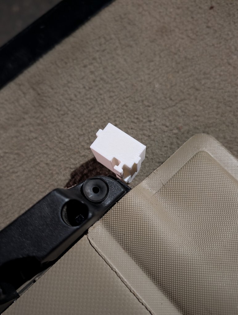

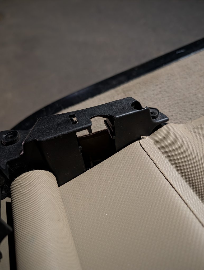

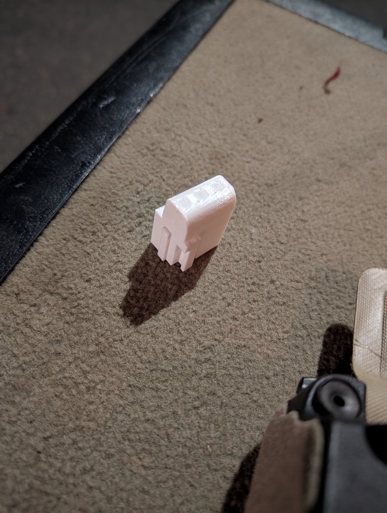

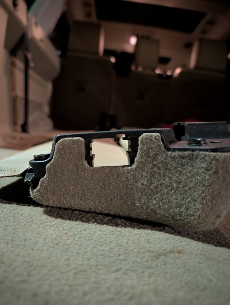

I printed this today and unfortunately I think my luggage cover frame has a piece missing so the thing just pushes all the way through and falls out.
So I tried using the retractable side as a pattern and didn't realize it was different dimensions. A couple passes through the table saw and I got it to fit, but it was crude and wasn't going to last, so I adjusted my model and this time it came out great. It uses the T slot with a stop to secure it in place.
I'll post the STL shortly, though it might require some adjusting depending on what the broken part from mine looks like if you still have it.

It does appear that our covers are slightly different. Glad you got it figured out.
ftillier
Jul 27, 2021
944
514
Portland, OR, USA
Thank you for inspiring me to fix it, it's been this way since we bought it in 2017 and on my list of things to tackle ever since.
