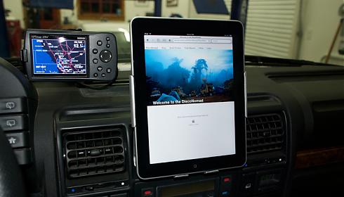

I'd like to see how you have that post mounted to the floor. I was thinking of a similar thing to hold an IPAD.
It is a custom bracket that I made. I altered/reinforced the seat frame and bolted the bracket on to that. Is just a short piece of metal tubing and a setscrew so I can pull the whole computer/dock out and have full function of the seat. Really should be a bit stiffer for my Toughbook setup (19 lbs with dock and pc). I'll try and find the pics I took of it when I made it.
