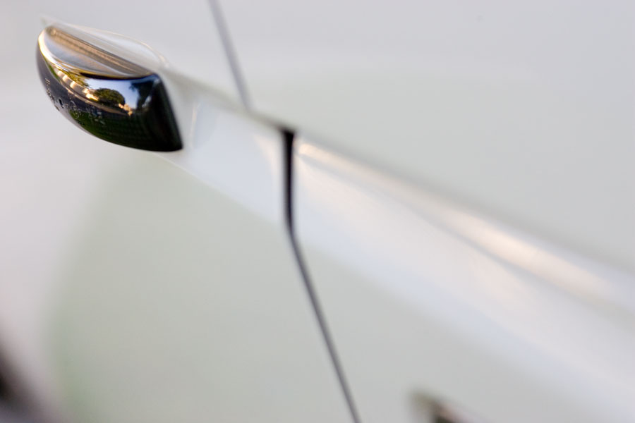

.. Recently I just purchased some clear side signal markers with mirrored bulbs.. is this a pretty easy install to replace the oem amber ones?

.. I wanted to have that Mercedez coupe look.. thats why I went clear. If you go clear, you have to get mirrored bulb housings ..otherwise, the bulb still shows through the clear.

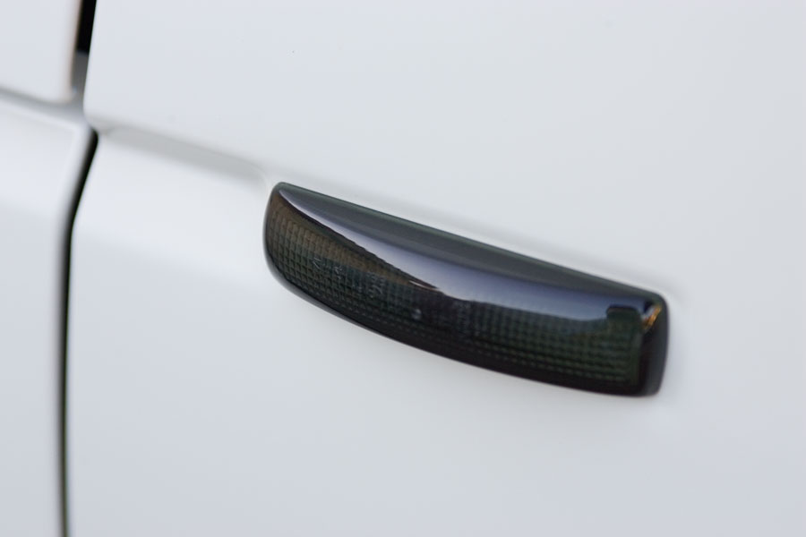

I went with smoked off of EBAY - very happy with the look
You slide the old lamp unit forward against it's metal spring clip - then lift out the back end first. Lamp fitting is a bayonet into the lamp lens.
Refit is reverse - easy to do, just take care not to over-compress the metal spring clip.

hey the smoked looks great on your white LR3! Great contrast..
I went with the clear (mirrored bulbs) on mine.. Low and behold I see the new 09's went with the clear markers too!
I wish you would of been around like a month ago.. when I got 'em in from Ebay I was worried about how to take them out, but I read the manual and basically exactly what you said is all that was needed to do it. Thanks!
