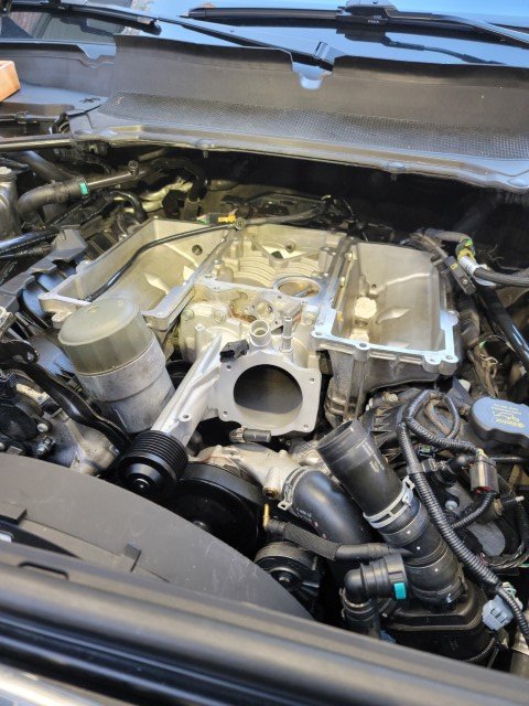

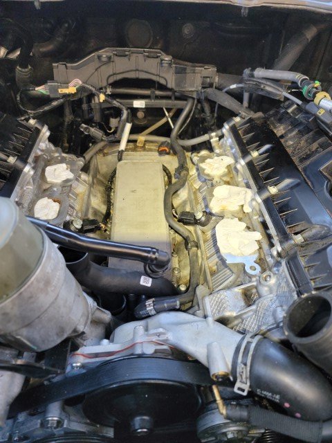

I picked up a D5 late last year up in Dallas after my lr4 was hit in Houston. Since I could not wait for a new vehicle to arrive i purchased used up in Dallas and brought it home about 3.5 hours away. I noticed a coolant smell when i stopped at a rest area but did not see where the level had dropped after checking it. Once i got home, i crawled underneath and still no signs of any leaks but still a strong smell. I decided to dig some more into this since it was stated by the dealership that it had been recently serviced. After checking all the usual areas, I pulled the SC off and when i check the cross over pipes they were brand new but had been force down into place. This appeared to have caused the rubber o rings not to seal properly. I decided to just replace everything new since i was that far into it. (even the rear cross over pipe). It was not too bad of a job to pull the supercharger but that might have been since it had been recently removed at the dealership. I did find an issue with the SC coupler as well so I had the SC exchanged out. Overkill yes but I still had a rental from the accident so doing all this then made sense.
I have not trusted dealership work from all the way back in the early 2000s when i had some work done on my D1 (Austin) that was not correct. Heck even with my D2 under warranty I would pull right in front of the shop (LRFW) and crawl under it to check their work.
