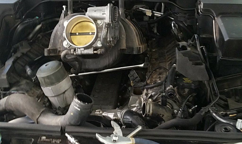

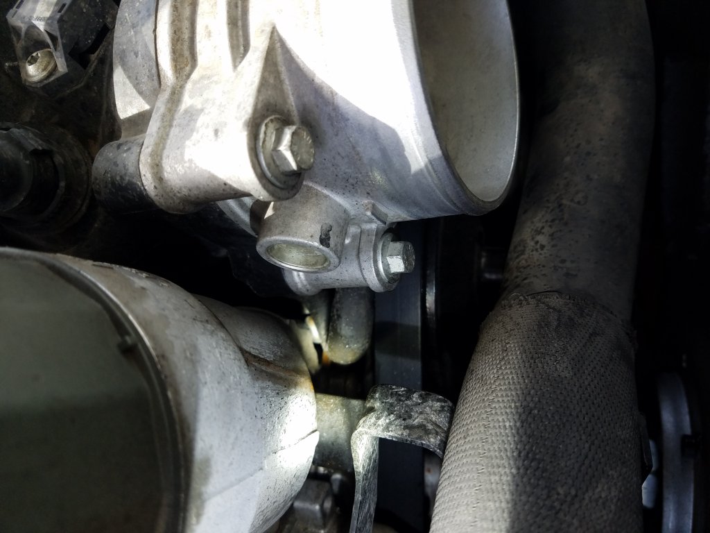

Well the low coolant light came on the other day, it was about a half gallon low. Discovered coolant on the front of the engine near water pump and under the throttle body.
Read a bunch of other forums and most lead to that, but I'm on a time crunch(moving) and need to ensure I get everything changed that's needed, do that want to get in there needing some other part. Any recommendations on other things to look at or change? Also where should I get a pump? Dealer wants 392 bucks.

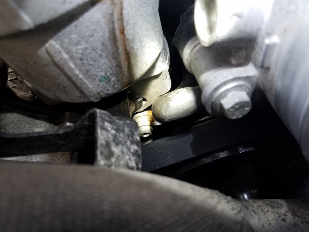

What colour is that coolant? It looks yellowish almost oily?
Just replaced a pump. I am going to assume your plastic crossover pipe is OK. To replace the pump you will need:
water pump ($80 ish from)
Plastic inlet pipe behind pump (had to go to Land Rover for this) about $25
both belts (one serpentine and one a stretch to fit. Might as well replace if you are in there.
idler pulley (again for a few $$ might as well.
I paid about $80 IIRC from Rock Auto (Beck/ Arnley) for the pump and the belts were another $30-$40
I needed 3-4L of Coolant (Pentosin SF, again from Rock Auto and make sure you used distilled water to mix it).

The coolant is pinkish, the photo doesn't look right. You ordered almost everything from Rock Auto, probably best prices? I do have a warranty but it's an aftermarket one I bought from the back when I bought the lr4. Not sure if the will cover it, I will give them a call.
1,403
Good. You should be seeing pink either fluid or dried crust around your pump. Yes I went with Rock Auto as the pump, belts,idler pulley and coolant were a good price. I would follow up with the warranty first though. Make sure they use the proper SF coolant.

When my pump failed there was an obvious wobble on the pulley. With engine off i would just check if the bearing has play at least you'll have an idea if that is the only problem.

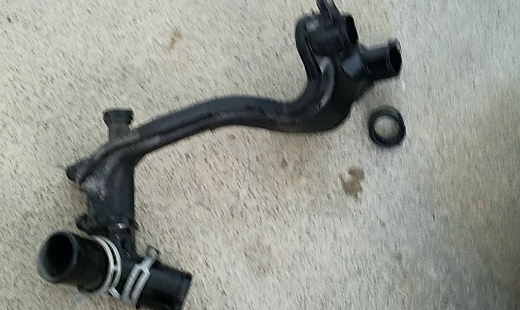

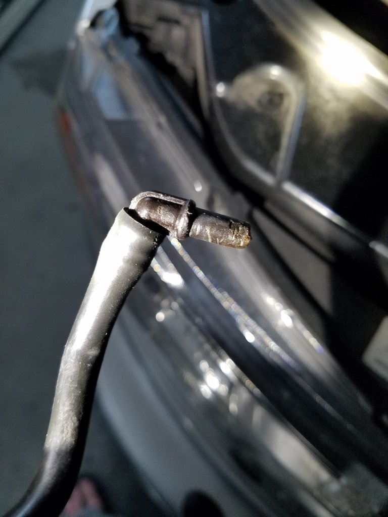

Well pump was replaced under warranty plus a 250 deductible. But the crossover pipe was cracked and they wanted 450 to replace it. I said I would do it and so I got it out and it was cracked along the lower seem and the two parts that mouth t in the engine block were busted off. Waiting for replacement to come in. One thing I noticed was the bleeder port on the water pump would spurt fluid when I squeezed the hose. Any idea where I can get this? It's the push in Port that connects to the throttle body.

Idk I got mine from local dealer not sure if part number though. Call and ask, how did the intake valves look?
