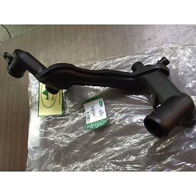

BTW any pic to show the crossover pipe?

Part # LR018275
hard to visualize with intake manifold in place. After I refilled my coolant form water pump replacement mine took a while to equalize and get all air out. It helped by filling from vent plug but still needed to add coolant for a few days until stabilized running front and rear heaters etc.

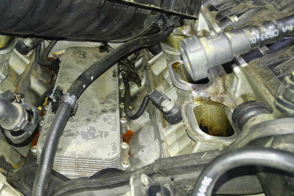

0922162050b-1-1-jpg.6526
part is at bottom of picture, it was leaking at lower left corner of picture where pipe goes into motor, you can see the puddles of coolant on mine.
