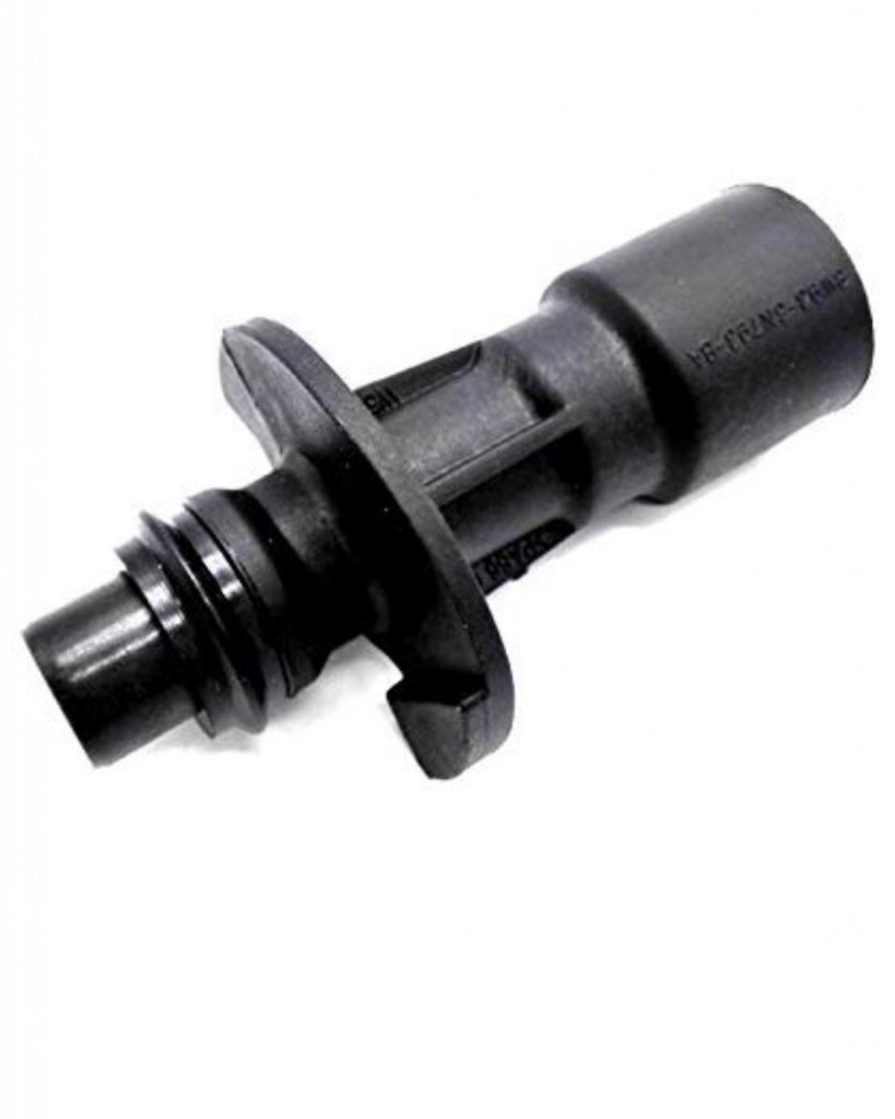

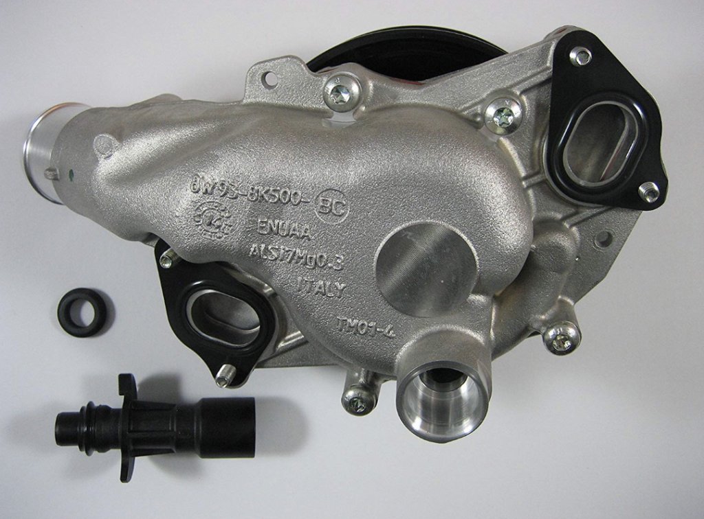

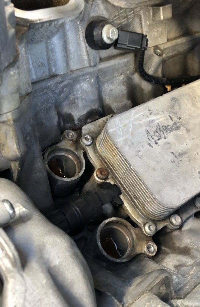

I have 2012 RRS 5.0 HSE Lux.
The crossover tube tends to crack. Best to replace it at the same time as the water pump.
Lesson learned for me. Had the same issue, drove me nuts trying to find the leak after replacing the water pump. LR service dealer mentioned that the the crossover tube goes out before the water pump majority of the time. Took me about 3-4 hours to replace both.
LR Service Dealer wanted about $1,800.
Parts: Water pump/outlet tube/O-Rings
Crossover tube (Flange tube)
+ Coolant
Spent about $450 on parts.
