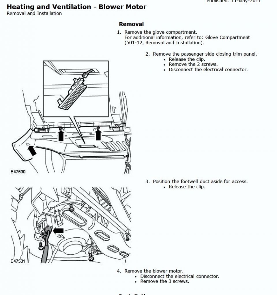

I have a dead mouse in my motor blower fan. Smells horrible and rattles when I turn it on. Dropped the glove box area and see the housing but would like instructions on how to remove if anyone knows. Thanks for any assistance!

See below... This is from the manual for the 2016 , but note the publish date is 2011, so probably pretty universal..

Hot tip for everyone. Slide a piece of sheet metal in between the filter and the blower, then remove the filter.
I regret not doing this today, a five minute filter change has snowballed on me.
