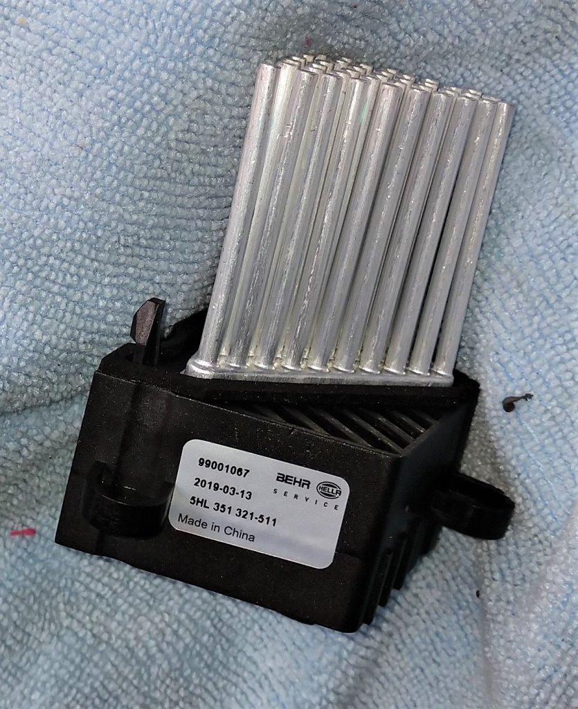

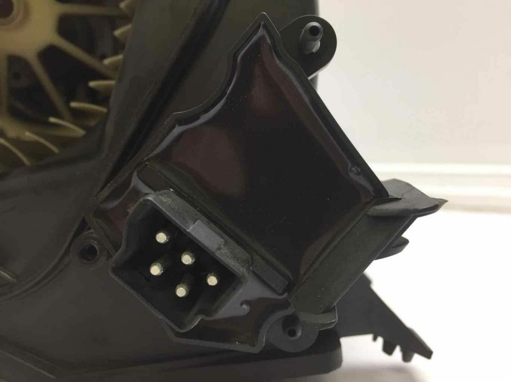

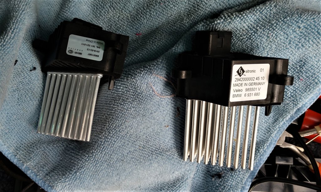

I did mine over a year ago. Still doing its thing for $45.00. My photos.left new module right defective.
bottom photo you can see the connector right side.

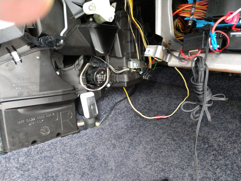

Is that resistor located on the side of the fan? And awesome write up by the way!
It's located to the side of the fan, but not on the fan itself. It's towards the center of the vehicle from the fan. It has cooling fins that insert into the ductwork that leads to the fan.
Here's a video explaining how to get to the blower motor for an LR3, but it's the same as an LR4.
The resistor is right above this guy's left hand at around 54 seconds into the video. It's a little bit further back than the blower motor. In this video, it's gray with a green connector on it. My resister was more of a dark charcoal, and my connector was yellowish.
This guy in the video talks about removing the ductwork to get the blower motor out. I did that when I removed the blower motor to check it out. You don't need to remove it to get to the resistor.
View attachment 11422 View attachment 11424 View attachment 11423
That doesn't look like an LR4. That part doesn't look anything like the resistor in my LR4, and the location looks way different.
Here is what mine looked like:
https://www.roverparts.com/electrical/fuses-resistors/LR031677/
It's located up and under the passenger-side footwell, to the point where you can't see it unless your head is down where the front passenger's feet would be (looking up and with the trim panel removed).
Sorry. 2011 Range Rover L311 blower resistor.
