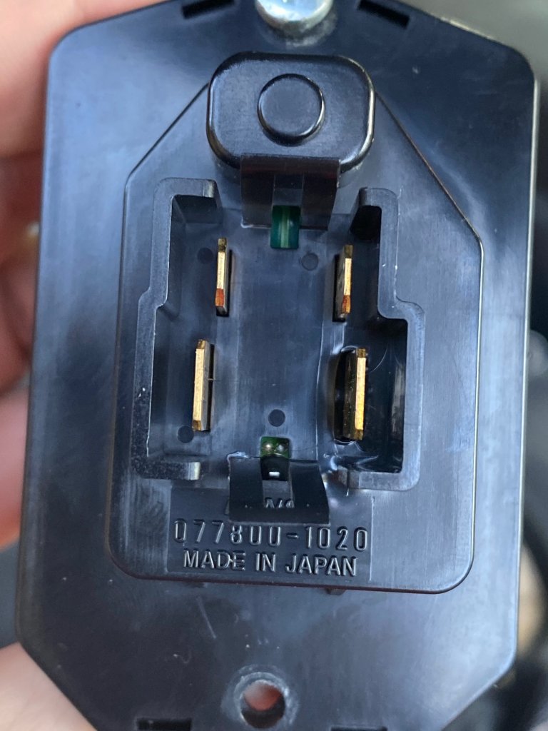

Here's what the old resistor looks like. You can see the bottom right prong has gotten hot, and it smells like a burned out electrical part. All the resistors I've seen online that have shot craps look just like this, so I'm guessing this problem is common when they go.
For those of us old enough to get this, imagine being psyched to see a part labeled "Made in Japan".
For the record I also love my Seiko diver and Sony mirrorless camera...

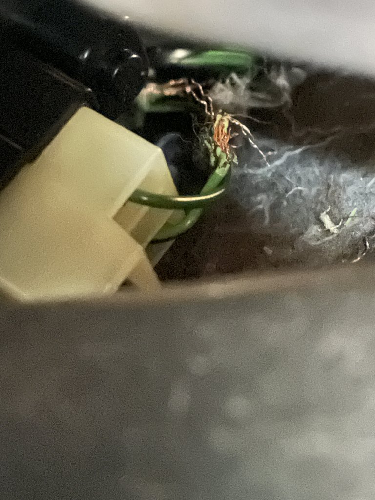

Might be moving from bad to worse over here… noticed a couple mouse droppings on the passenger floor mat while opening things up ahead of swapping in a new resistor. Photo attached suggesting compromised wiring. Will investigate…

After fixing the wires leading to the resistor, my blower is working correctly again. Thanks @ryanjl for pointing me in the right direction.
Thankfully, it doesn’t look like there is any additional wire damage back there behind the glove box. I did notice some foam in resting atop the cabin air filter, suggesting the rodent is/was working on accessing the cabin air inlet. That’ll be another post for another day!
