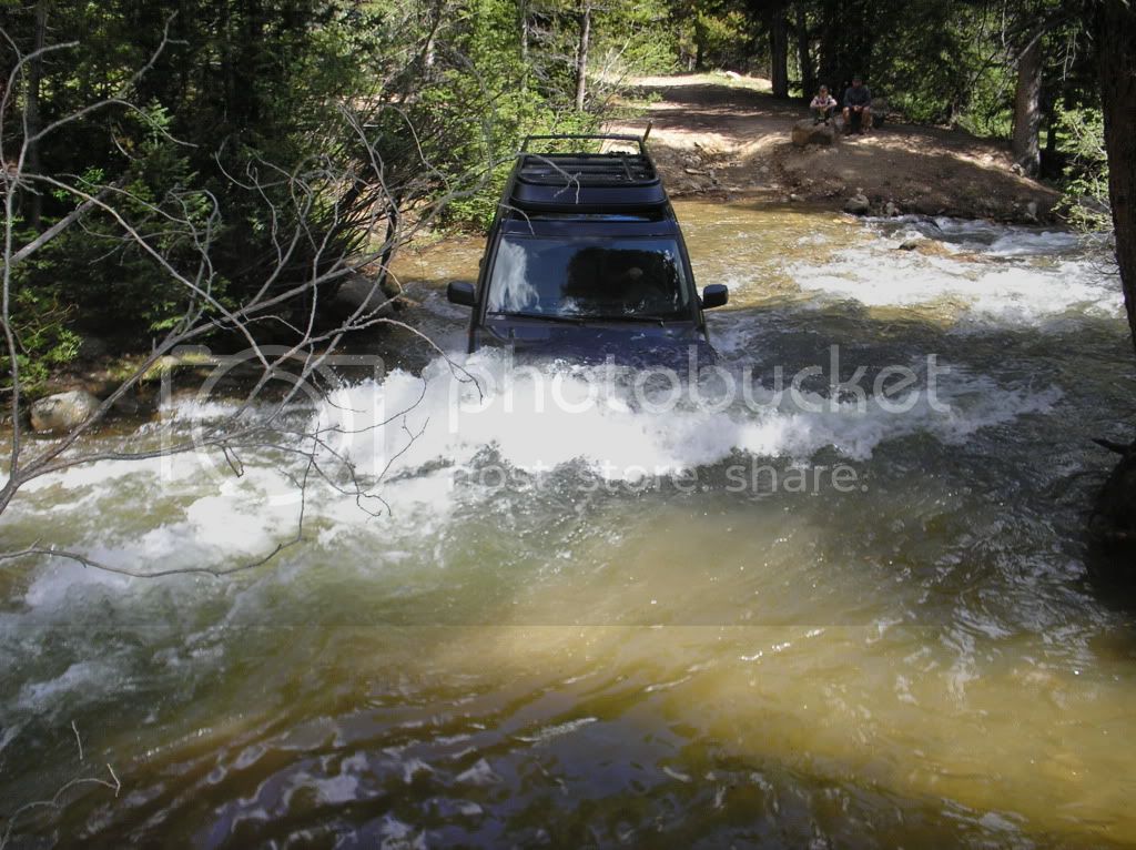

I been in over my air intake (accidentally) without a snorkel in a rushing river...luckily the intake hole is downhill from the airbox in the engine bay. There were no leaks whatsoever. I would say that if you keep it below the windows (with snokel installed) for short periods of time, your golden.
http://s874.photobucket.com/albums/ab304/mikem_lr/Halfmoon Creek 20090627/
Just look for the black LR3 on page 2... hint... it's mostly under water.

We did that one on the final day of GD4. Not quite as deep (thankfully), but still a pretty fun one. :biggrin:

Not to be cynical. . .but what is wrong with that picture? Take a look at the concors condition of the LR3 in the river. Doesn't it seem odd that someone is doeing such ********* 4x4 fun. . .and yet the truck is absolutely stunningly clean? Not a speck o mud or dust or anything anywhere. I gotta be doing it wrong.
When I do things like that. . .the truck is a mess after only a few short min's. . . Java Black magnetically attracks dust and dirt right off the road it would seem. I gotta find out what wax that guy uses:smile:

Maguier's is the best... Just don't look too close at the paint job. After that trip and the GD4 last week, it took me about 3 hours of washing, Scratch X, polishing and waxing to get out the pinstriping. There are still a few nasty gashes though. Gotta love the battle scars.
