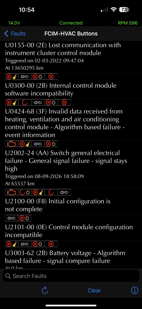

My AC has been acting up much like OP describes. I have to turn off and on the AC, maybe multiple times to get AC to blow cold. When I run the faults with the GAP tool I get the below HVAC errors. Will replacing the compressor fix the issue(s)? Thanks.

I'd replace the battery unless it is known good and reset the codes to see if they come back.

@lmwong Most of these codes seem to relate to the instrument panel. If you haven’t already done it, I would clear all of the codes, then use the car and run the codes again. See if anything shows up. Then try to reproduce the problem, and run the codes again and see what shows up. You might have a short or a bad switch in the instrument panel someplace.
I ordered a replacement HVAC instrument cluster and installed it today. It fixed the issue! All codes cleared. Thank you!

That’s great. If you could post the part number that you replaced, it might be helpful to someone in the future. I’m guessing it was HVAC Temperature Control Panel - LR070848.
That is indeed the part number. I bought one off eBay from a wrecked 2016.
