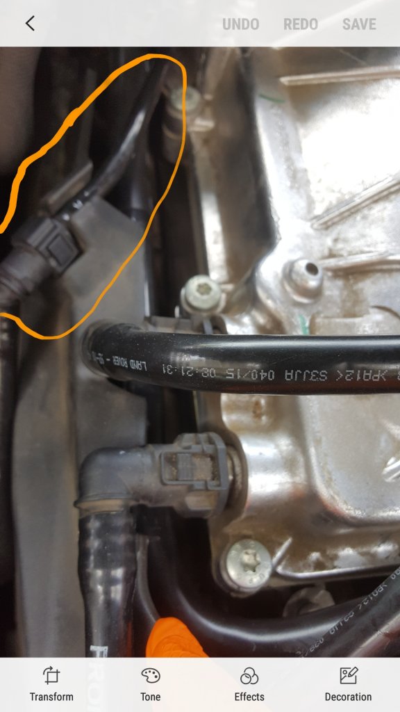

My guess is your pcv valves on the back passenger side valve cover. They sit right next to the battery box on top of the valve cover (two circular disk looking things on the V8- I think it’s only one on the v6). You should get a too lean code though if you have a big leak. May be the start of something. The pcv valves are cheap (~ $30) and a 10 minute job. Just make sure you don’t do like I did and snap the brittle valve cover tabs that hold the pcv valve in place.
photo below.

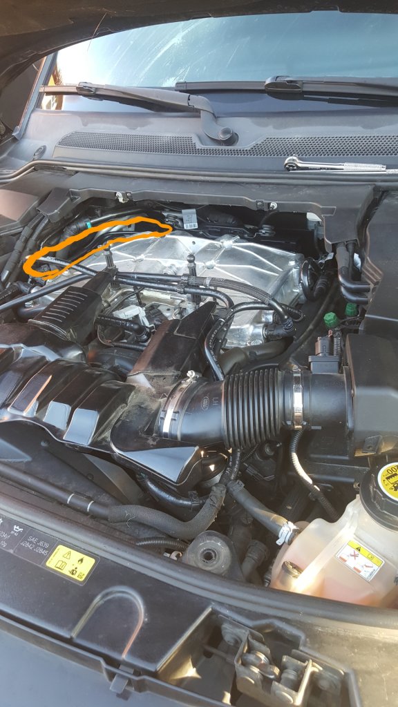

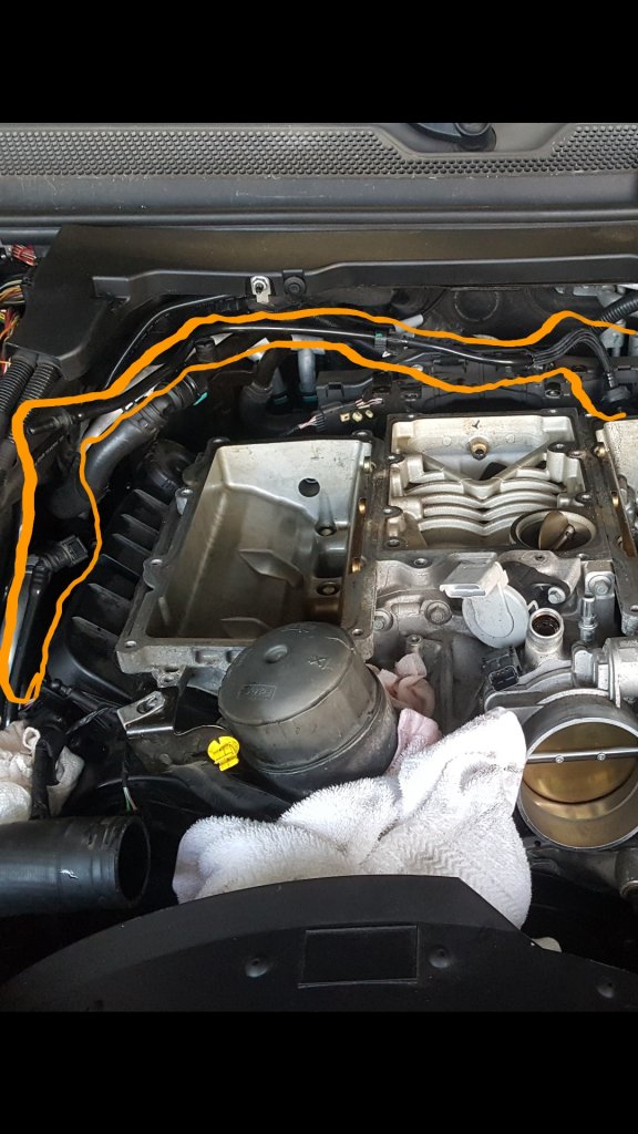

Along the passenger side, in between the air intake and engine, and battery compartment and engine, there is a long, sectioned vacuum line that runs from the vacuum pump to the intake manifold. I would trace this line:
It may look a little different on the 5.0, but same concept--vacuum line tracing from vacuum pump to intake manifold.
Also, do the PCV valve diaphragms as Scott suggested. If you have a length of vacuum hose sitting around, push one end into your ear and use the other end to listen for air noises. The shorter you can safely make it, the better it will work.

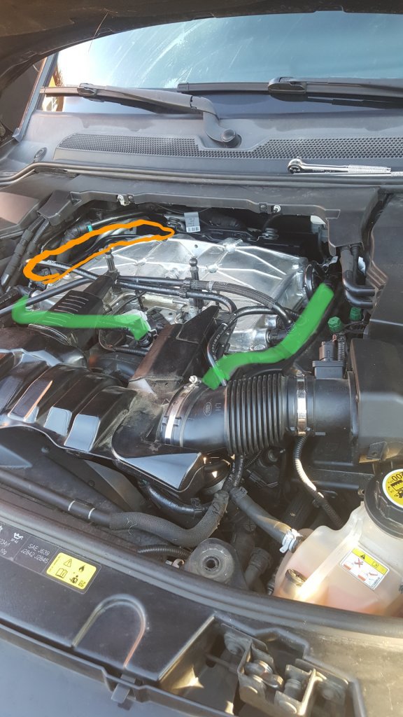

Just to pile on the suggestions - check the vent lines from the valve covers as well as the PCV valves. I highlighted the areas in green on Michael’s photo. There are two. One on the driver’s side valve cover that connects directly to the air intake (I’ve had this one pop off when I didn’t connect it properly). The other (passenger side) leads from the PCV valve and connects to the throttle body. I assume these are the same on the 5.0, but I have a 3.0.
But I agree with the others that it sounds like the PCV membrane starting to go. Mine made a sound somewhere between a whistle and a moan that I could only hear right after I shut the engine down. I first thought it was a pulley going bad.
