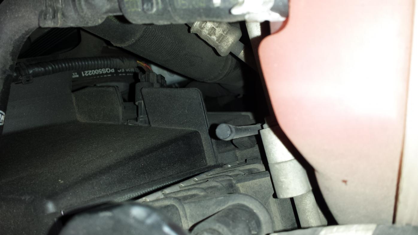

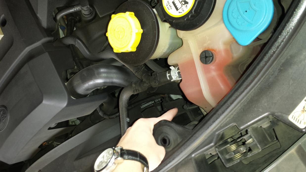

How can one tell if the installed breather is old or updated?
BearishDriver
Aug 7, 2014
256
Open your bonnet and check it, if it looks like this one it is the old one, otherwise you've got the updated version.
You can google the part number for an idea of what the new one looks like

schwaggy
Jul 25, 2007
50
Thank you. Mine was the old style so I just ordered the update.
My rig is 2009 but it looks like the TSB didn't come out until 2009.
I kinda expected to have the update. Crazy it took LR pretty much the entire production run to issue the TSB and updated part.
