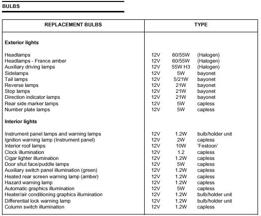

Do the all-red tail lamps take different turn signal bulbs than the tail lamps with amber markings? The all-red lamps don't have a hole cut big enough for a turn signal bulb, unless it takes a smaller bulb or something I don't know... Do the all-red tail lamps have blinker capability? If so what bulb do I need for them or do I need to cut out a bigger whole or something?? Please help if you have a discovery 1 with all-red upper tail lamps (without amber)... Do they have a turn indicator? Thanks

Does anybody know what type of bulb the turn indicators take on those?

Hope this helps...

Actually what I meant was the bulbs from the amber blinkers don't fit in the tail lamps without the amber blinker... It's like a smaller hole, or it looks like it might not even hold a bulb. Do the all red tail lamps even have blinker lights? (I'm talking about the upper lamps, not the bumper lamps). I think the all red lamps were made on the Disco 1's before 95. Then they switched to the amber style after that from what I was told.

I don't think they all have dual filliment bulbs, I am pretty sure that most are single filiment bulbs.

By the way. Do you know what slot is for the brake lite. The top or the bottom. 94 Disco 1.

Pretty sure the top hole is the brake light, and it is a double element bulb. Make sure to examine the socket for signs of melting. It is pretty common to happen.
