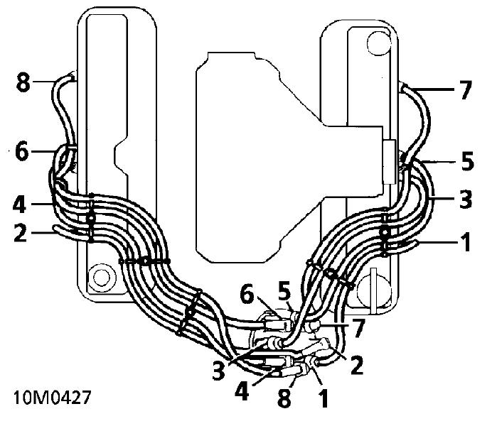

I have a 1995 Land Rover Discovery 3.9L. I was wondering if anyone knew the Distributor Cap Order
TomB
Jul 3, 2009
Or the number one postion and also the rotary direction

Here you go (should be in your owners manual as well)
