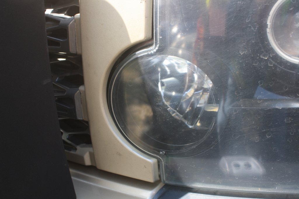

So I finished taking the headlights apart again and painting the interior pieces black gloss with wheel and rim paint. This seemed to be the best reflective choice. I decided against another type/set of DRL's as I didn't like the look once everything was painted black. I also removed the previously placed black tint, as I think it doesn't need it on the HL's anymore.
All lights shine great even the amber signal light bulbs, which I took a dremel and cut out the amber lens in front of the Turn signal bulb, now amber. You can't even tell the difference when the blinker is on whether it has a lens or not.
Oh and a word of caution, do not try to clean the chrome finish off of the plastic pieces in the headlight assm if you do this, all of the silver comes off in chunks, as I unfortunately found out, causing more sanding with 800 grit wet/dry paper than I wanted.

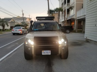

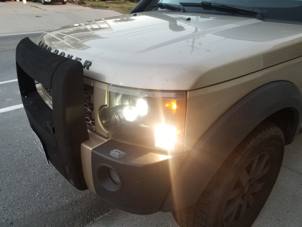

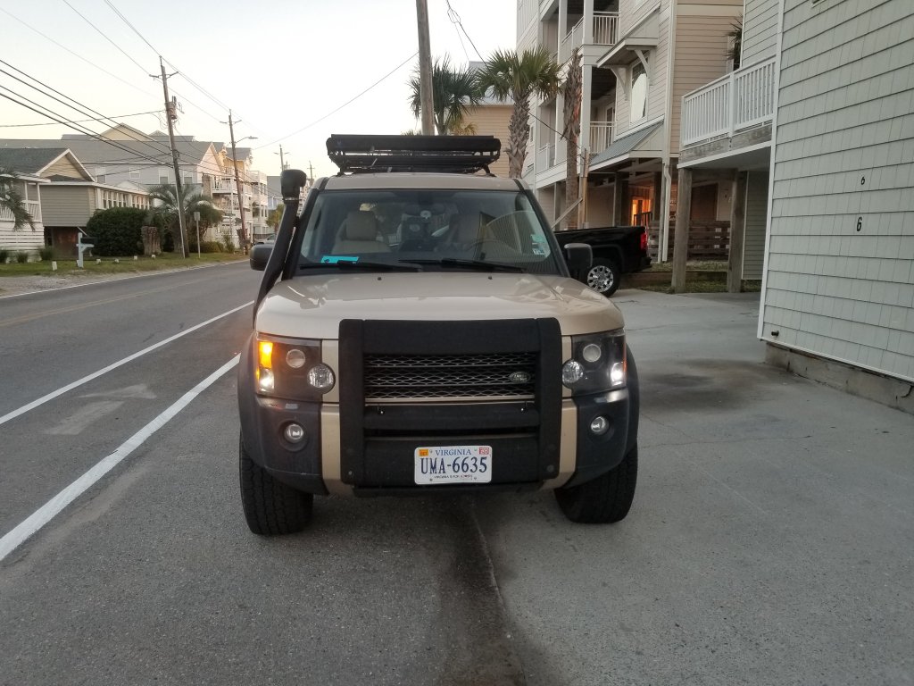

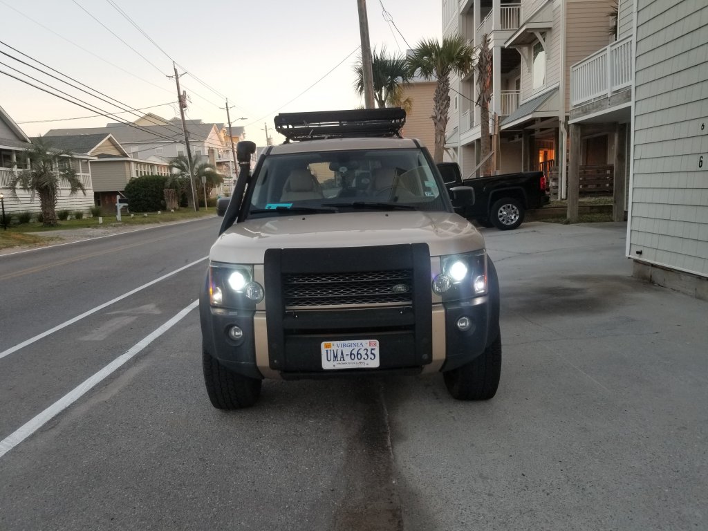

So here's the pics. Didnt want glare so took at dusk
I was very happy with the way the turn signals look with a gloss black reflective painted back and a missing amber lens. You can hardly tell ther is no amber lens, but it sure makes a difference in the day time not seeing that big amber tango lens.

It looks good...I like it. I'm not gonna do it, but I dig it. Oh...take off that stupid front license plate, man!!! That will give your look a real boost!!
