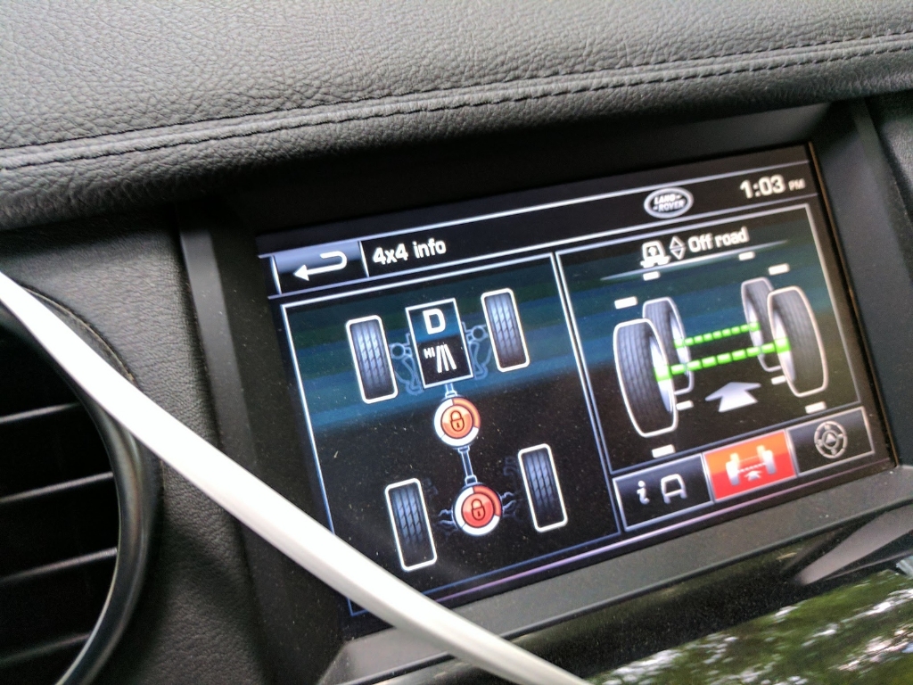

It kicks on pretty quickly with grass/gravel/snow mode on icy roads.
This is what my 13' looks like with the rear locked up a little (it has 3 segments the progressively increase as it locks up)
