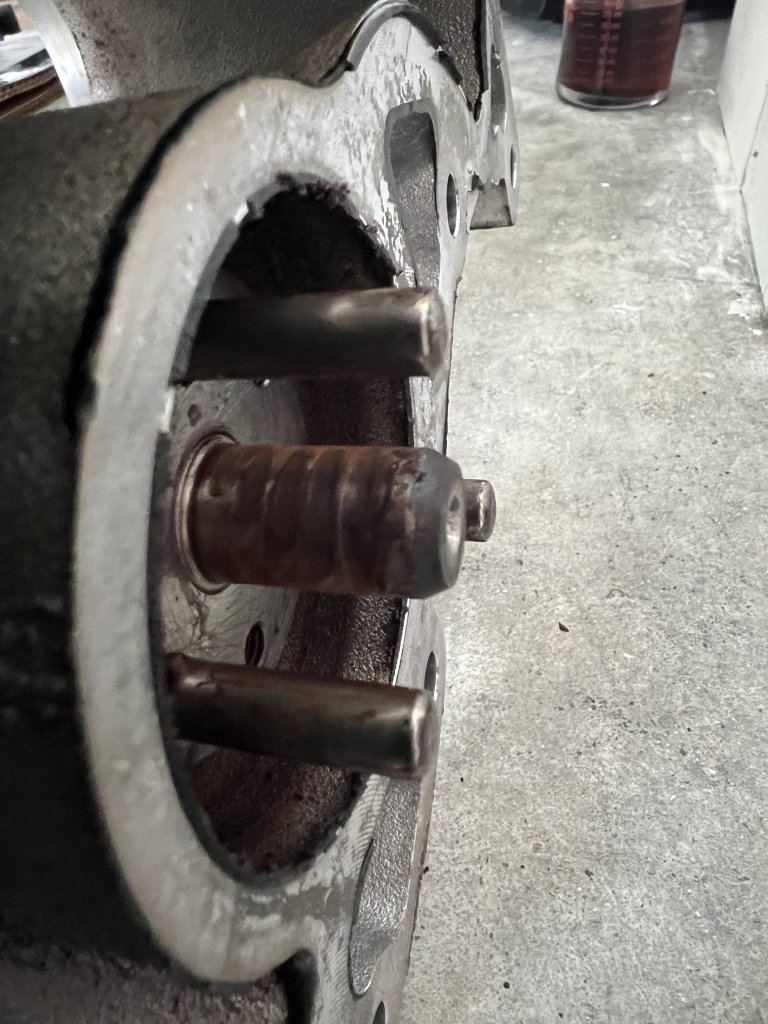

Snapped a pic of my sc shaft when I did the sc oil/pulley/coupler/snout at 85k mi. Not because of this, but I went the rebuilt snout route with new coupler. You can see all 5 coils of the spring on the old coupler were wearing into the shaft.
