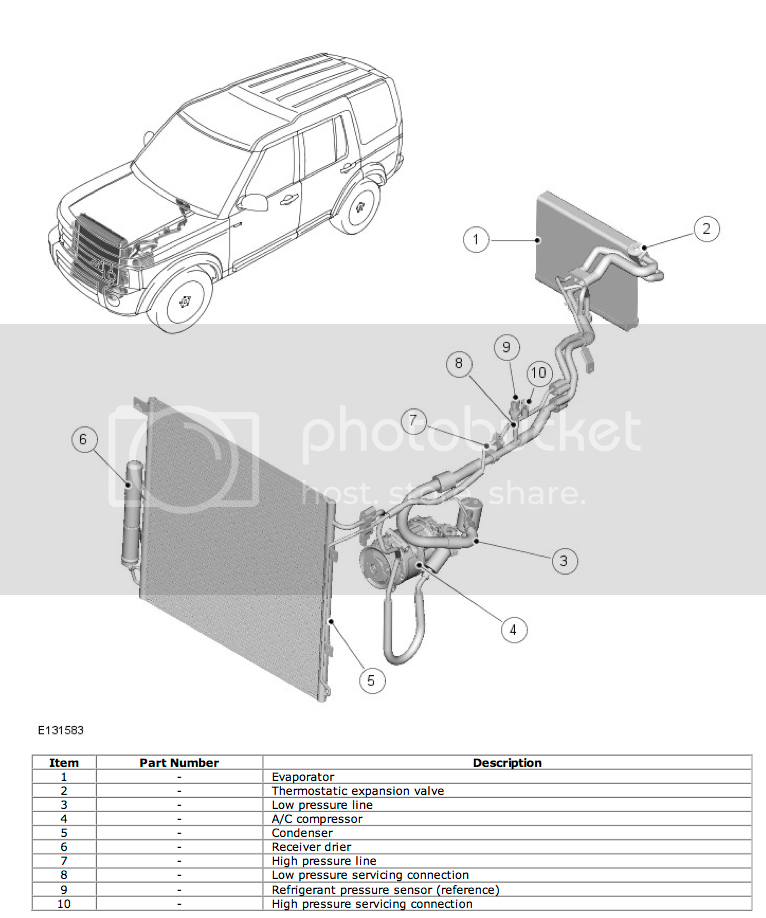

Well, we've only had the LR4 a few weeks and I'm occassionally getting that musty smell out of the vents when you first fire everything up. I remeber a dealer mentioning the evaporator core being cleaned as part of their "service package" at some point.
I've cleaned these on other vehicles with a can of cleaner that foams up and covers the evaporator coil, then just drains out. Anyone done this one an LR4? I pulled the pollen filter last night and felt the fan just below it. I would assume the evaporator core is right around here.
Any help would be appreciated.
