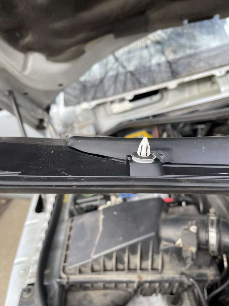

Y’all have convinced me, I’m pulling my trim caps off as soon as the weather gets just a little warmer.
@RoverTide, where did you source the little black circle tape? Or is this one of those “ductape” will work just fine?
I guess we’re just sealing the hole up, and since the guides are clipped, I wonder if some heavy duty sealant would be a more permanent seal?
The big question will be, I literally just replaced the clips 4 days ago, how many will break when I take the trim panels off! LOL!! (Seriously, I’m guessing at least one or two. SMH)
I just got the clips from Atlantic British and they came with the circle tape (for the top holes only). I think as long as you get some tape with really strong adhesive that can withstand really cold and really hot temps, you're good, but sealant would prob be even better. If you look real close in the picture I posted above, I used duct tape on the very bottom hole. I doubt it will last forever, but will prob be good enough until I have to get under there again.
I just hope you don't break the plastic on the a-pillar that holds the clips... I had to epoxy one back together. I assume warmer weather or a little heat will help prevent breakage.

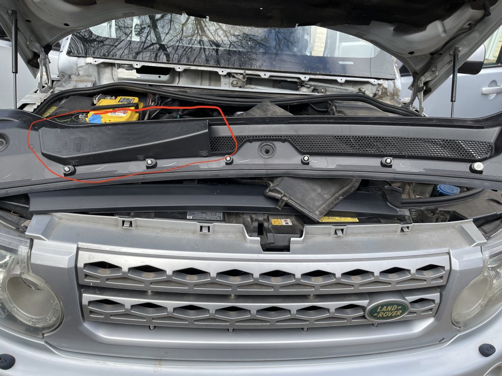

I literally just glued some plastic...probabaly not the longest term solution, but at least it'll get me back up and running in the short term. In theory, the cowl should be blocked, but it's got some "weak spots."
Here's how the under side of my replacement cowl looks. (sorry, I didn't look at. the OE when I swapped them, they might be different.)
In theory, the area circled should be "blocking" anything from flowing or falling in...
In reality, there are a lot of gaps and cracks, and there really isn't a good seal between the windshield and cowl...so there's that.
Looking closely:
It really is just a crap design. I mean, why couldn't they just cut the corner a little bit more so it doesn't extend in front of the windshield?
