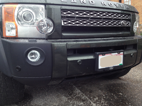

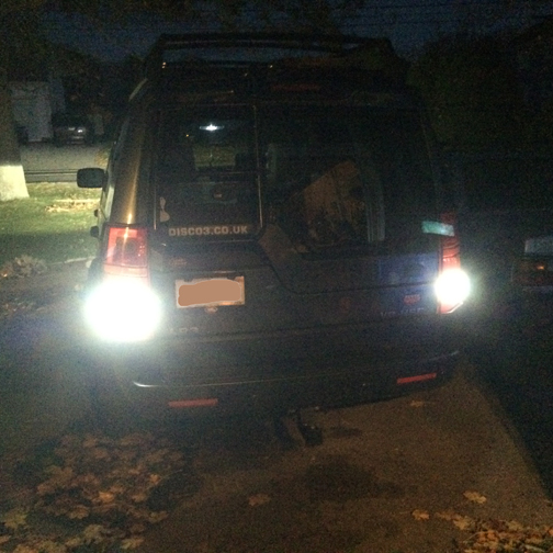

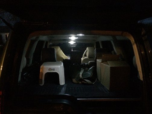

I've replaced all my interior bulbs with LED's and a few bulbs on the exterior. I've added drl halo lights to my fogs to match my adaptive headlights, leds to my license plate and reverse lights. Going to do my front turn signal next. I've added some pics below.

These are the ones I got for the interior
http://www.ebay.com/itm/10x-T10-505...Bulb-DC-12V-/121284257587?hash=item1c3d1ae733
and these are the ones for reverse lights.
http://www.ebay.com/itm/1156-BA15S-...Parts_Accessories&hash=item3cec803af9&vxp=mtr

Thank you. The ones for reverse look huge. Did they fit ok? Any issues with them?
Mx468
May 26, 2012
168
No issues they work great. They're really bright and great when using the remote in conjunction with the follow me home lights.

Nope, didn't want to mess with them especially with all the computer problems these LR3's get from just a faulty brake light. I just use the oems. Also couldn't justify shelling out over $400 just for led lR4 brake lights. I could think of 20 other things I could use that money for on my LR3. If you do switch to lr4 brake lights, you will need to add a resister. Google LR4 rear brake lights on a LR3, theres tons of info about doing the switch.
