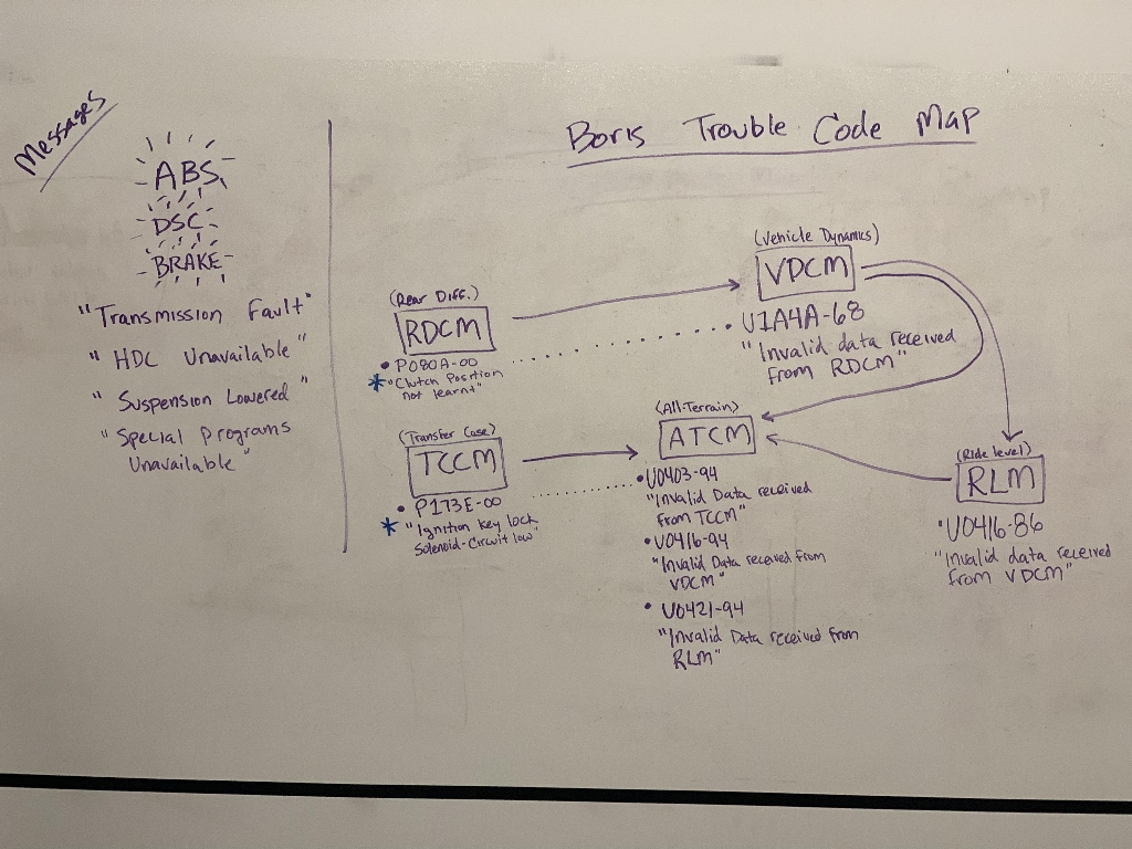

Diagrammed out my current fault codes. Need to look into the ignition lock solenoid one but I think I’m on the right track with the rear diff.

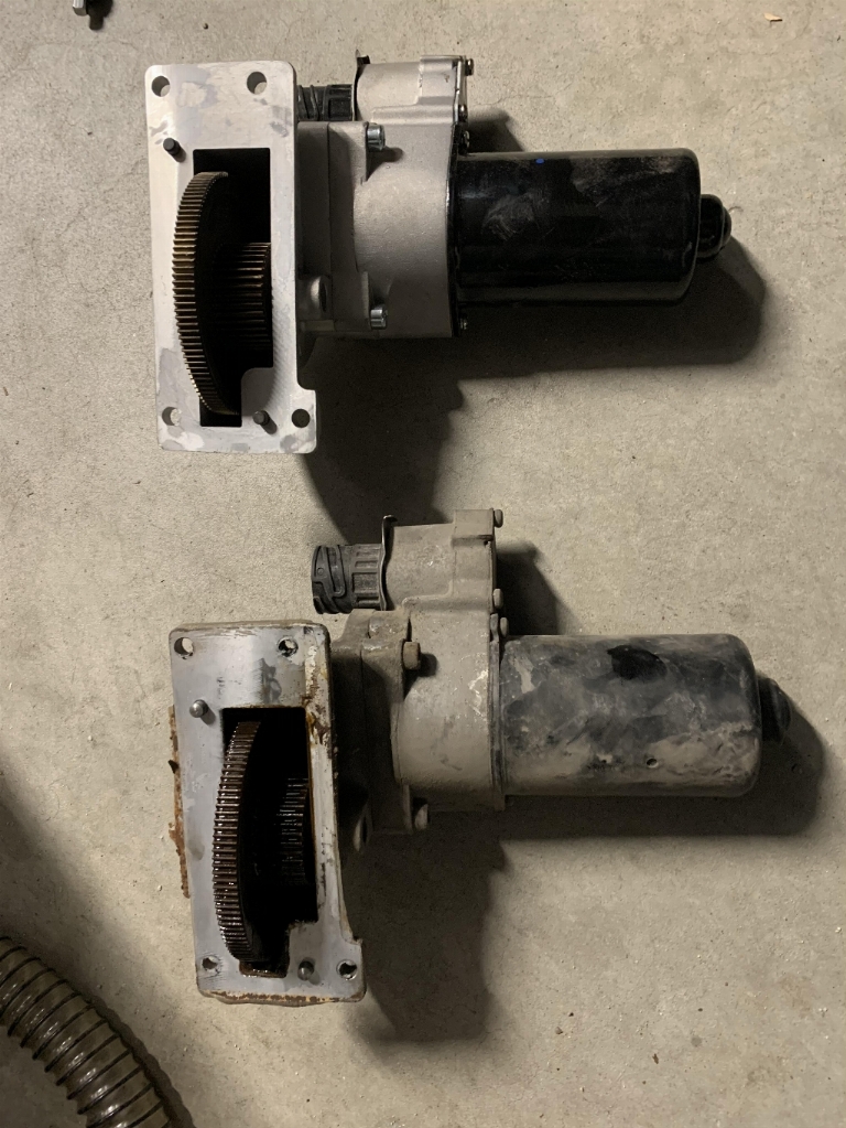

Replaced the rear diff lock actuator assembly. Old one was seized up...definitely toast. Unfortunately no change. I am running out of ideas!
Does anybody know what wires I should check to ensure the rear diff is getting power?
I am also wondering if I need to revisit the transfer case module? It had just a tad of corrosion on the 9 pin plug. Opened it up and everything looked good visually. I might get a used one just to rule it out.
