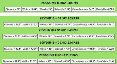

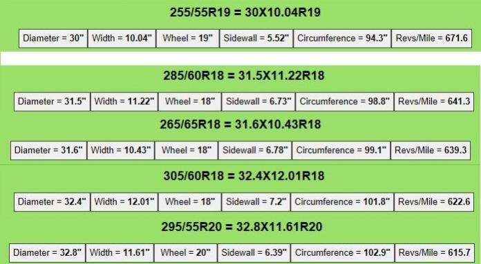

I think the point we are trying to make is that your sizes are so much different than what 99% of the LR4 community use, you are going to be hard pressed to find much useful information here. There is quite a bit of info on tires and fitment on this forum if you do a couple simple searches.
Bottom line is, the biggest size most people go with without mods are 265/65/18 and 285/60/18 (31.56 inch and 31.46 inch diameters respectively). Your proposed sizes are significantly bigger in both width and diameter and would require extensive modifications. These would include grinding frame horns, cutting plastic arches, and possible AC line relocation in the rear passenger wheel well. I can only assume further mods will be required for the 305 width (12.01 inch wide) tire. I have never heard of anyone using this wide of a footprint!
Here's a quick size chart for the stock, usual upgraded sizes, and your proposed sizes:
