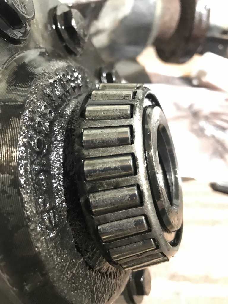

Day 2 of this rebuild and I’m about to throw in the towel. Removing the diff was straight forward but a huge pain! Split the case and immediately saw the bearing that was bad but they are almost impossible to get off, I’ve got one side left to do but there is just nowhere to get a punch or pulled to remove them. I’m definitely way over my head on this so unless you’ve got experience rebuilding diffs and specialist tools then I wouldn’t attempt it. In the photo is the bad bearing. As you can see it has to be pulled off somehow but there is nowhere to place a puller. Pulled the roller sleeve off hoping to get it on the little lip around the top edge of the bearing but no luck. Ended up taking 2 hours and carefully cutting it off( somehow without hitting the shaft it sits on) maybe I’m dumb and you can find a better way or get the right tools

That looks like tough bearing to pull. I would not attempt that without a special fixture.

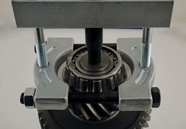

Don't give up. You've got the hardest part.
You'll need a bearing separator.
I bought one from Harbor Freight ($40 with coupon) in preparation for this job. Didn't get started tho.
