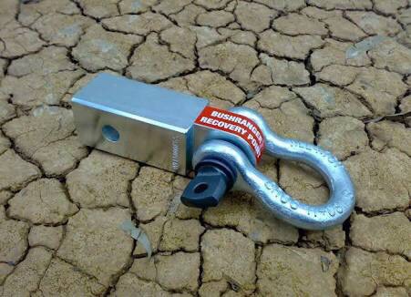

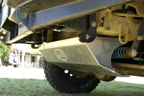

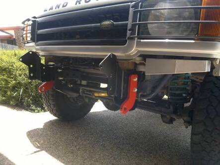

Railey
Dec 10, 2015
ImageUploadedByTapatalk1454821924.603392.jpgImageUploadedByTapatalk1454821943.475772.jpg
