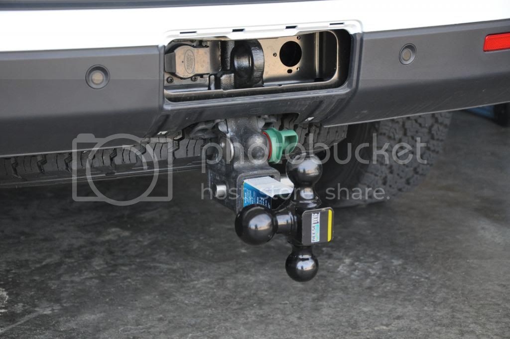

Ok, as a Land Rover rookie here allow me to ask a question. I see a posted picture of a tow hitch recovery attachment. It also appears this would mount directly below the tow hitch receiver at the rear of the vehicle.
First, am I correct? Second, based on on training I received for the recovery procedures & use of a Cayman MRAP (admittedly, clearly a VERY different beast in both weight, construction, and use than a Land Rover) we were strongly cautioned to only use hard recovery points and never the tow hitches. We were explained that tow hitches were designed for direct pull/force in a single direction and not recovery points which exert different forces in a different manner. Are tow hitch recovery accessories common use in Land Rovers?
I ask because I had a small degree of comfort with recovery operations based on this training but am I a victim of my own ignorance? Admittedly my training was vehicle specific and therefore it may be absolutely worthless outside that realm and/or simply stated as a risk reduction measure.

The big recovery ring on the bumper is meant for recovery... a hitch mounted one would reduce clearance due to the hitch and be less strong I would think...

The easy answer is that you have much better recovery point right above the hitch, so there is no reason to use the hitch. That's an LR4-centric answer.
In general, a tow hitch could be used as a static recovery point (e.g. pulling with a winch) but I wouldn't use it for a dynamic (****** strap) point. As you say, they are designed and rated for static loads. I've seen plenty of instructors show how to use one as a recovery point though. Similarly, if you are planning to pull someone out using a ****** strap, attach it to your recovery point, not your trailer hitch.

Forty Deuce, you are correct in all your assumptions. The photo of that hitch recovery attachment was posted by a member unfamiliar with the LR4's built-in recovery points, and based on his experience with Disco 1 and Disco 2, which are very different animals.. For several reasons listed here, a hitch receiver is NOT a recommended recovery point for the LR4, but the factory points hidden under removable covers on both front and rear bumpers are, along with some suitable D-shackles and ****** straps.

Yeah it was me. I was going by the OP which asked about locations to bolt on aftermarket hooks/rings, so I posted a couple photos of them. I am used to lifted D1 and D2's. Apologies.
