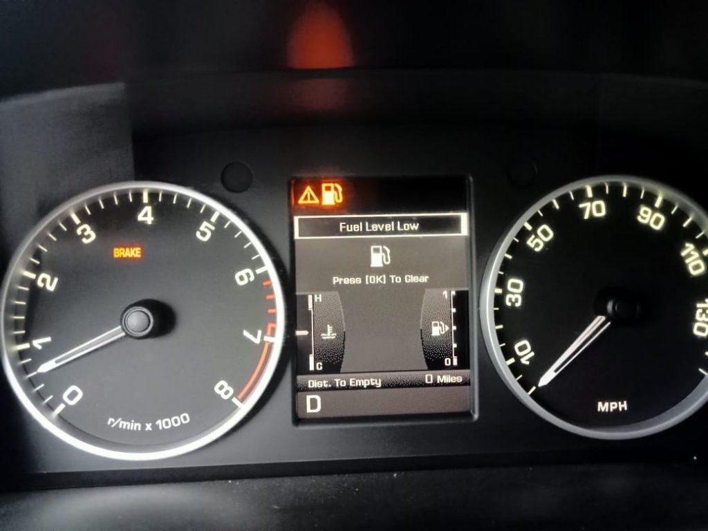

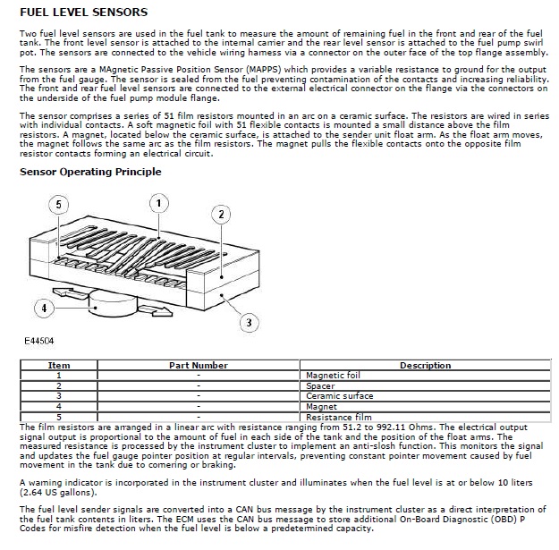

So the other day let the fuel get real low to where it was showing 5miles remaining. Filled it up with about 2-3 gallons. Gauge never moved after driving and multiple restarts. Filled it up later that day and I was showing approx 25-30 miles short (range to empty) of normal. That was about a week ago and same deal. Anyone ever experience this?
Short of dropping the tank and investigating and thoughts?
