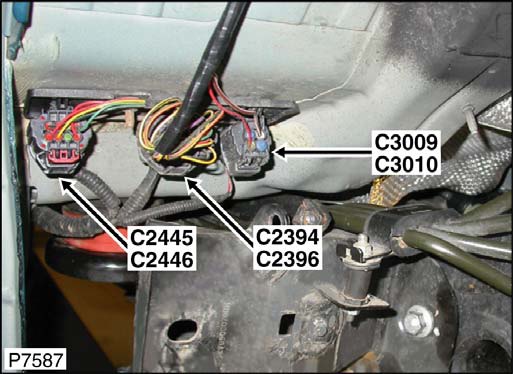

see photo attached

Thanks for that but I do not have anything like that - my model is a 2007 built but 2008 model so maybe they are different. I have written to Land Rover Customer service asking them where the connectors are so we will see what happens.
Is that the left hand side front wheel arch?
Thanks again

This is from the 2005-2009 repair manual, they are all the same.

Have found the connectors - on a MY08 model they are in the engine compartment above and below the LH headlight
