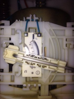

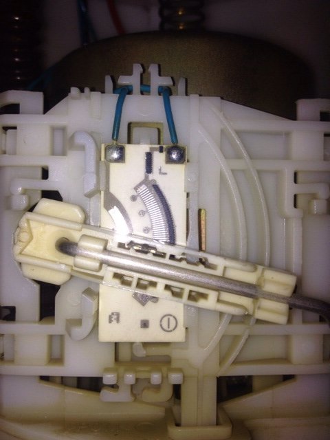

Have a Freelander 2002, 1,8
The fuel indicator works perfect, but the wrong way.
When the tank is full it show empty, and goes slowly to full as the tank get empty. Checked the fuel gauge in the tank yesterday, the printcard fits just one way otherwise it can't read the arm correctly. Tried to switch the two cables from the printcard, same fault.
I was told that it is two partsnumbers that can be used regarding the car number. And that it's a change in medio 2002.
Question:
Do anyone know if the two different models read opposite ways?
I can see that it is a L on top of mine, I think it means low? but then the tank is full. I think this have part number YAD000070, is it anyone that got a YAD000080 and can see if that one is different.
Add a picture if you have one.
Maybe they works
Live in Norway and nobody got it in stock, I have to order and pay to check.
Look at the attached picture
Hoping for an answer to get this stupid problem away
