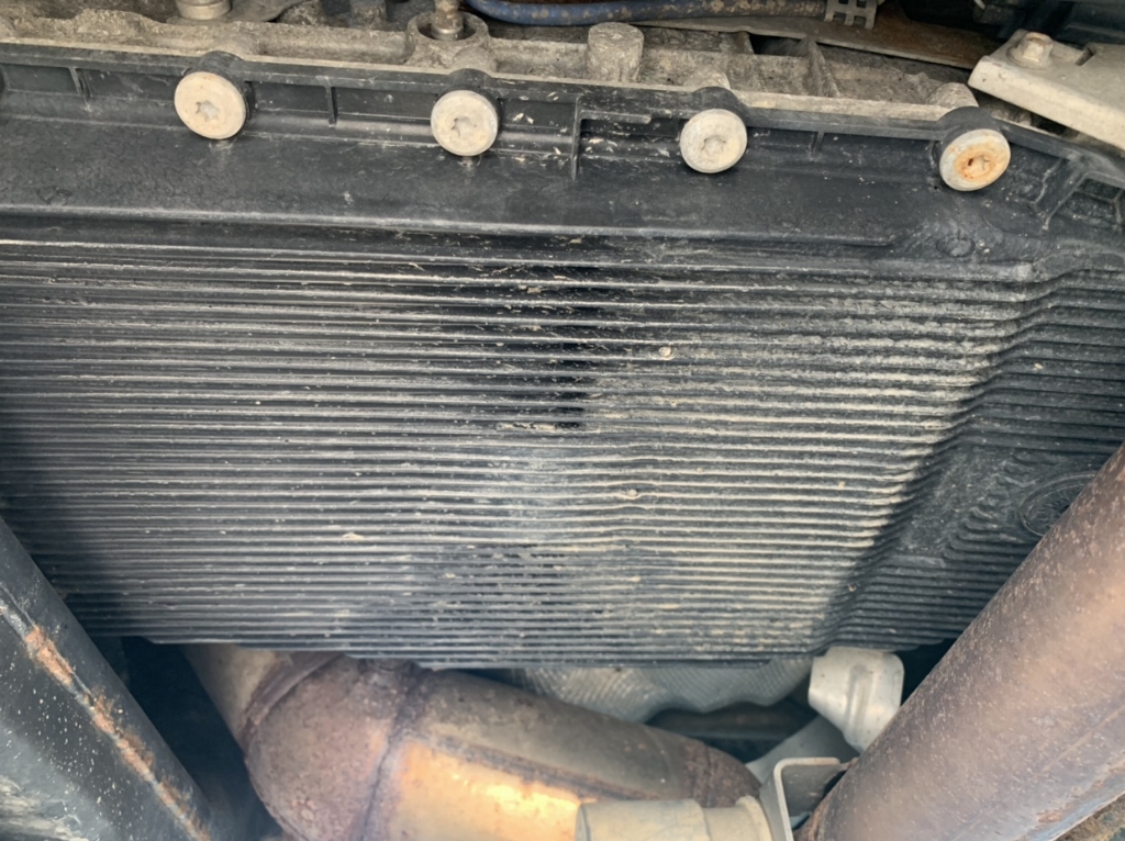

nymoto
Mar 1, 2016
87
68
Thanks all. Will check on the pan in the am and report back if it’s plastic or not.
I wish I could do my work myself but I live in Brooklyn with no garage - regardless of it needs to be done it will be somehow / someway.
- AG
nymoto
Mar 1, 2016
87
68
Damn! it is plastic, just checked
Guess I have some service to take care of ASAP!
Will report back again after I figure this out / have it done.
Damn it!
