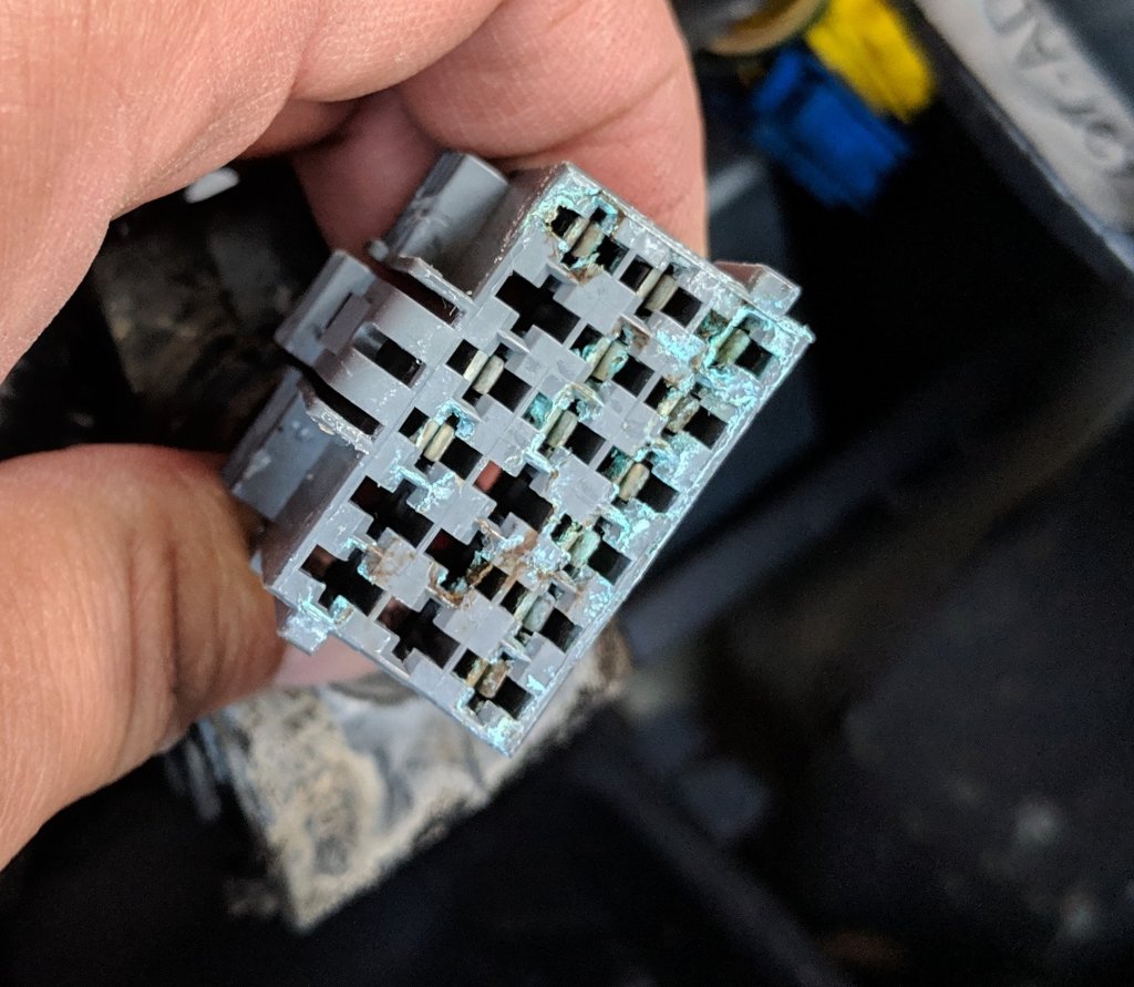

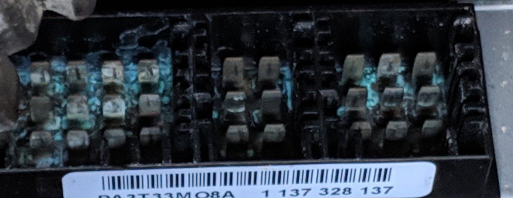

Having the same problem with mine. Found corrosion in Transfer case module and harness. Replaced cowling with silicone bead and brake light switched at first. Now will clean the corrosion issue and hopefully that will solve fault errors.
