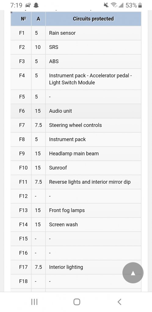

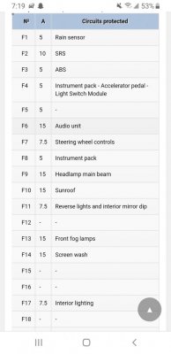

No worries, I have found it, it's F9 in the fuse cluster found in the glove box. However, what does the column 'A' stand for? Its value is 15. Is that ampage?
Phill
Sep 5, 2017
Sweden
yes that is the amps, check to see it has blown, sry about the delay in replying was working yesterday.
