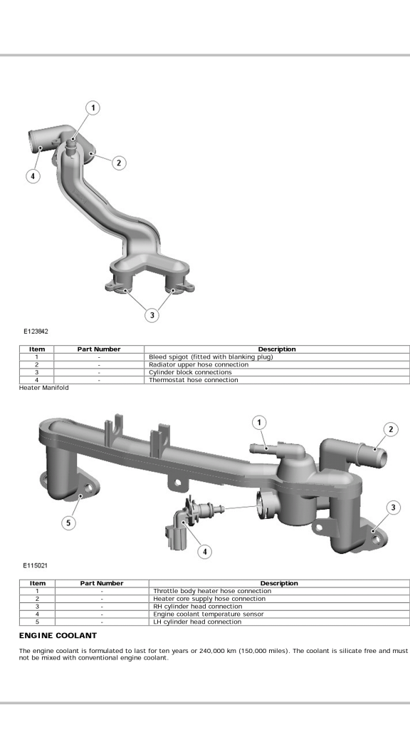

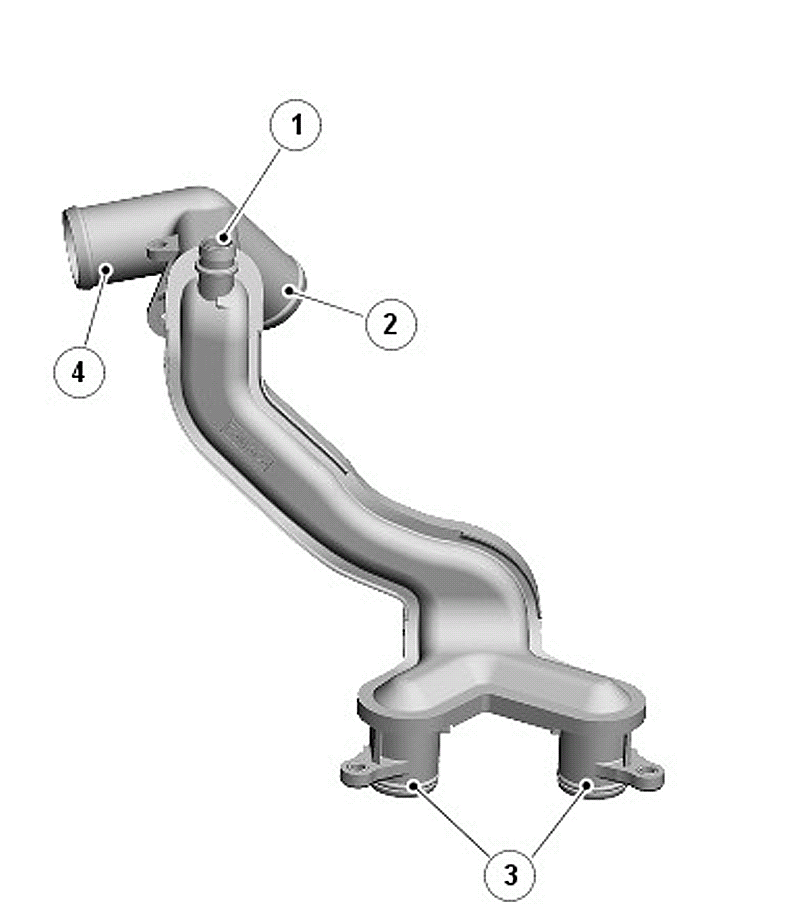

Thanks. Its at the bottom of the first picture I should have taken a close up but you could flex the plastic and the seam would open up 1mm or so. It was leaking above #3 at the junction corner View attachment 6528
This is the one i replaced, down where number 3 is where the plastic seperated.
There is also a small plastic piece that goes to the oil cooler under the plenum.
stufrowin
Mar 14, 2015
111
25
The part I was trying to think of is called
the heater manifold LR077042. Just wondering if anyone has had this fail on their LR4. Seems common in the Jaguar but the LR tech told me not so much in LR4. I hope he's right.
