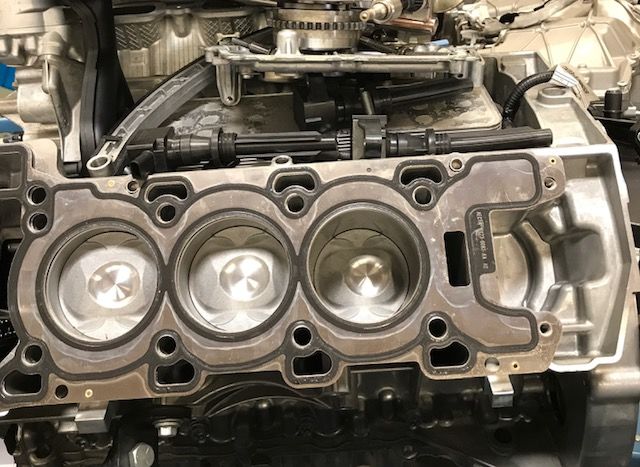

I'm 34K miles into my 2015. Being a daily reader of this forum, I've seen plenty of threads pertaining to cross over pipe failures. My understanding is that the MY 14 and newer use the AJ126 block while the later models, MY 13 and older use the AJ133 block. Although the AJ126 block is a V6, the overall design, is built around the AJ133, has me wondering if they share any parts, mainly the cross over pipes.
I found a picture of the mysterious "deleted 2 cylinders" of the AJ126.
1,403
Cool photo. So they kept the block size the same. Crazy how they went through all of that in the quest of 1 mpg and less power. The V8 would have been great behind the 8 speed.
