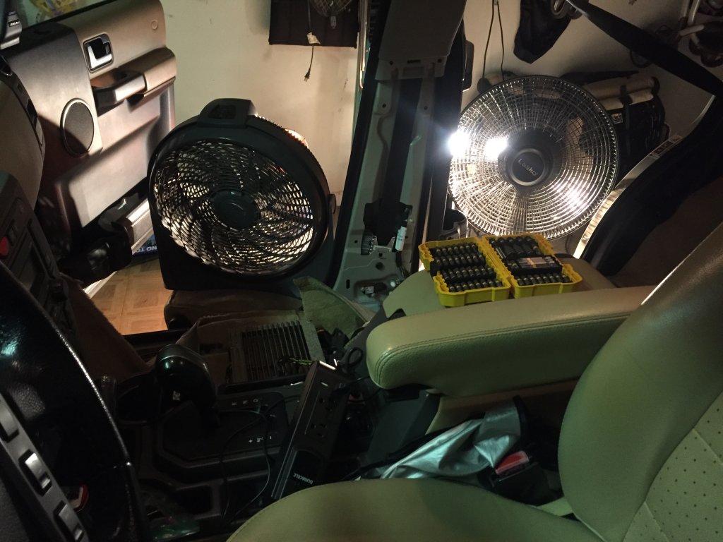

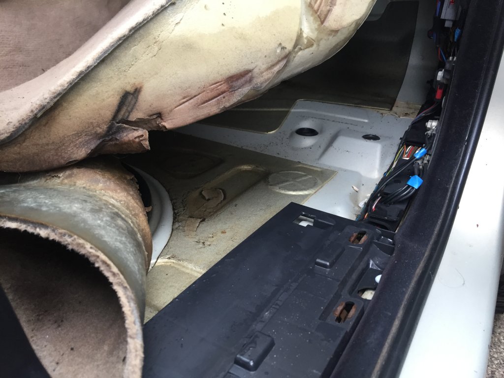

I've had to tackle the soaked carpet today. Tore out the second row and passenger chair to clean, dry and assess the damage. I know this is the dry rot elbow. So I'm attempting that repair tomorrow. I'll be fishing a new line down the A pillar and connecting the new to the old. Should do the trick. Credit to jereme on YouTube for the nice explaination on what he did with the vid.
Tonight I'm running two fans and a heater to dry out the cabin. Tomorrow I'll clean the carpets, trim pieces and put it all back and then go after the drivers side.
What a pain this is.
