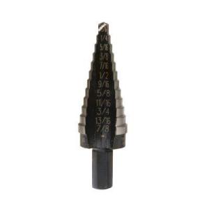

Now I don't have access to a 9mm drill bit, but what I ended up doing worked great. I used a step drill bit to enlarge the hole to 9mm. The step bit was an English bit, but this is what I did. 9mm is between the commonly found 5/16" and 3/8" diameters. 11/32" would have been really close, but I did not have a step bit that size. I wanted to use a step bit for a clean hole, more important because of how the rivnut works. I drilled through 5/16" and towards the 3/8" step of the bit, but not all the way to 3/8". I carefully took more and more metal off past 5/16" until the rivnut fit through the hole snugly.

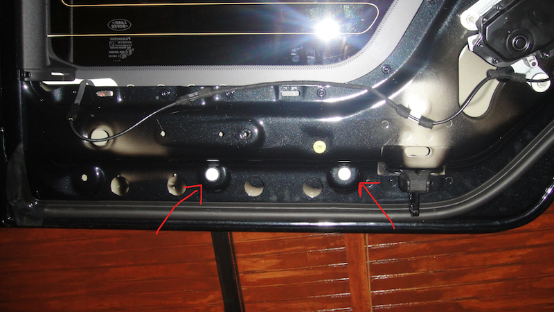

I used an 11/32” drill bit and worked my way around the hole until the rivet fit into the hole. Pretty well marked by the directions where to drill.

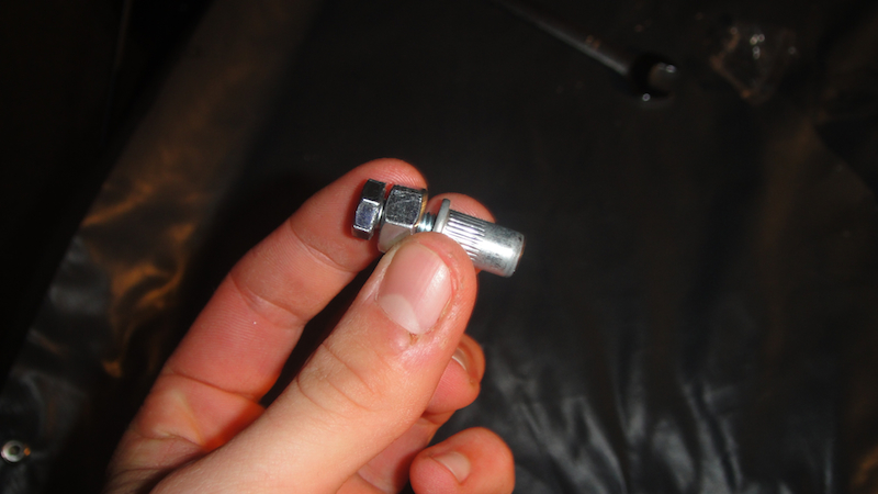

Putting in the rivet isn’t that bad. I had a nut that was slightly bigger than the provided bolt and just held it with a wrench. The rivet would spin around a little bit at first, but it stopped once I kept tightening the bolt. Don’t over tighten the rivet once it's secure.

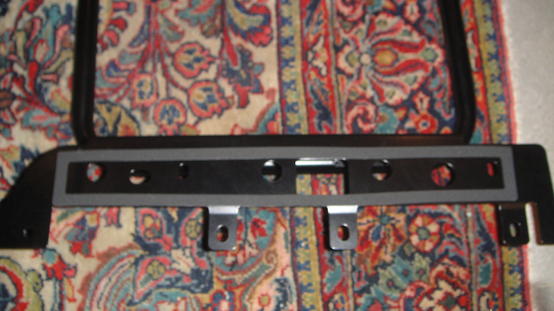

Sorry I didn’t take a picture of it, but I cut the double sided foam tape for the top of the ladder pretty much in half. That way you can easily hook the ladder on to the top of the rear door and then ease it down without the tape making it difficult. There’s a picture of the foam that you add to the bottom part of the ladder.
