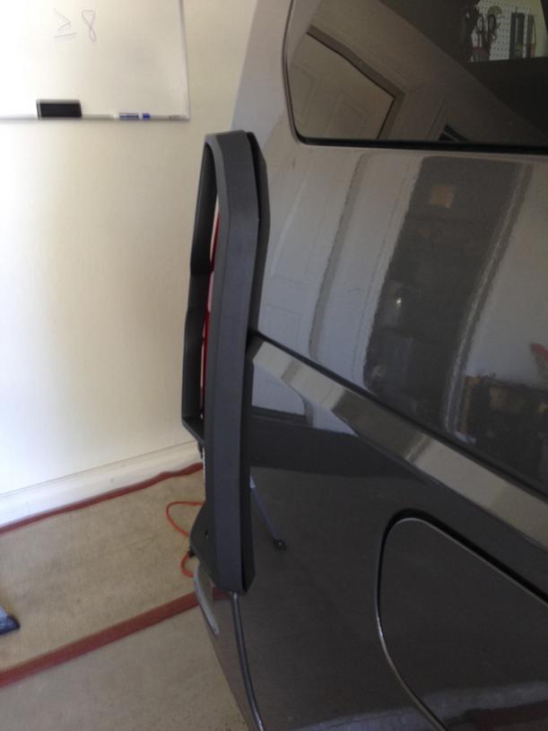

Step drill bit or rivet gun for the rear lamp guards? Just looking for consensus based on who of you used either mechanism.
I used a drill according to the instructions and then a rivnut tool.
spizzi
Jul 14, 2013
165
Have others done anything additional to seal the hole?
I could be wrong but I checked the official LR instructions for the rear lamp guards and ladder; neither indicate a requirement to seal bare metal for corrosion protection.
I could not locate instructions for the VPLAP0008 front lamp guards but my guess is that same.
spizzi
Jul 14, 2013
165
Not yet. Waiting for some 3M silicone automotive sealant to arrive. Might have to wait until this weekend.

All done!
Took me 4.5 hours but I spent 1.5 hours marking the holes and then triple guessing, then checking again :)
Turned out great!
The close up picture doesn't really show it well but the lamp guards are touching the body of the vehicle as they should.
Didn't need a rivnut gun - did some MacGyver stuff with $8.50 in parts at the hardware store.
