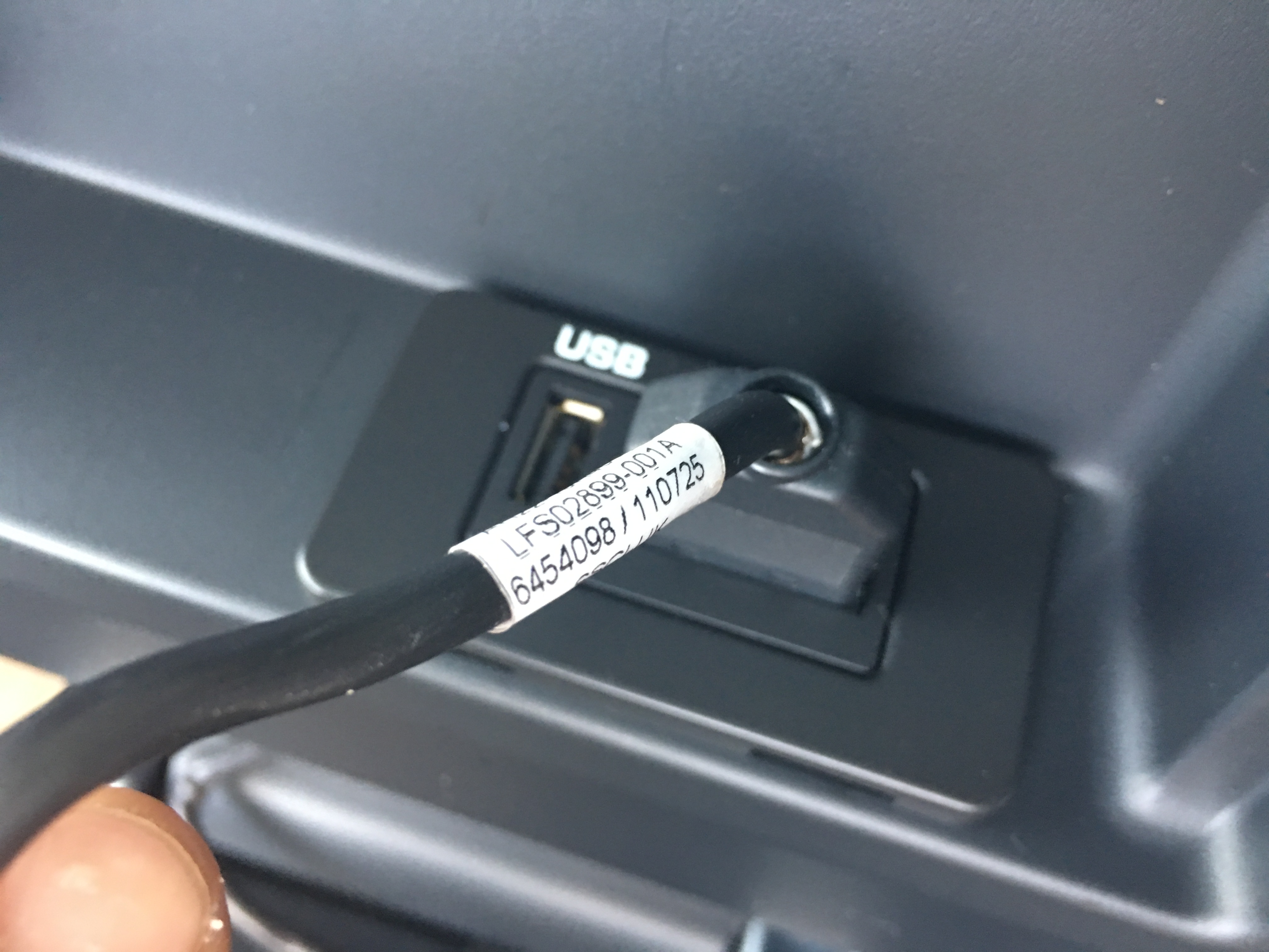

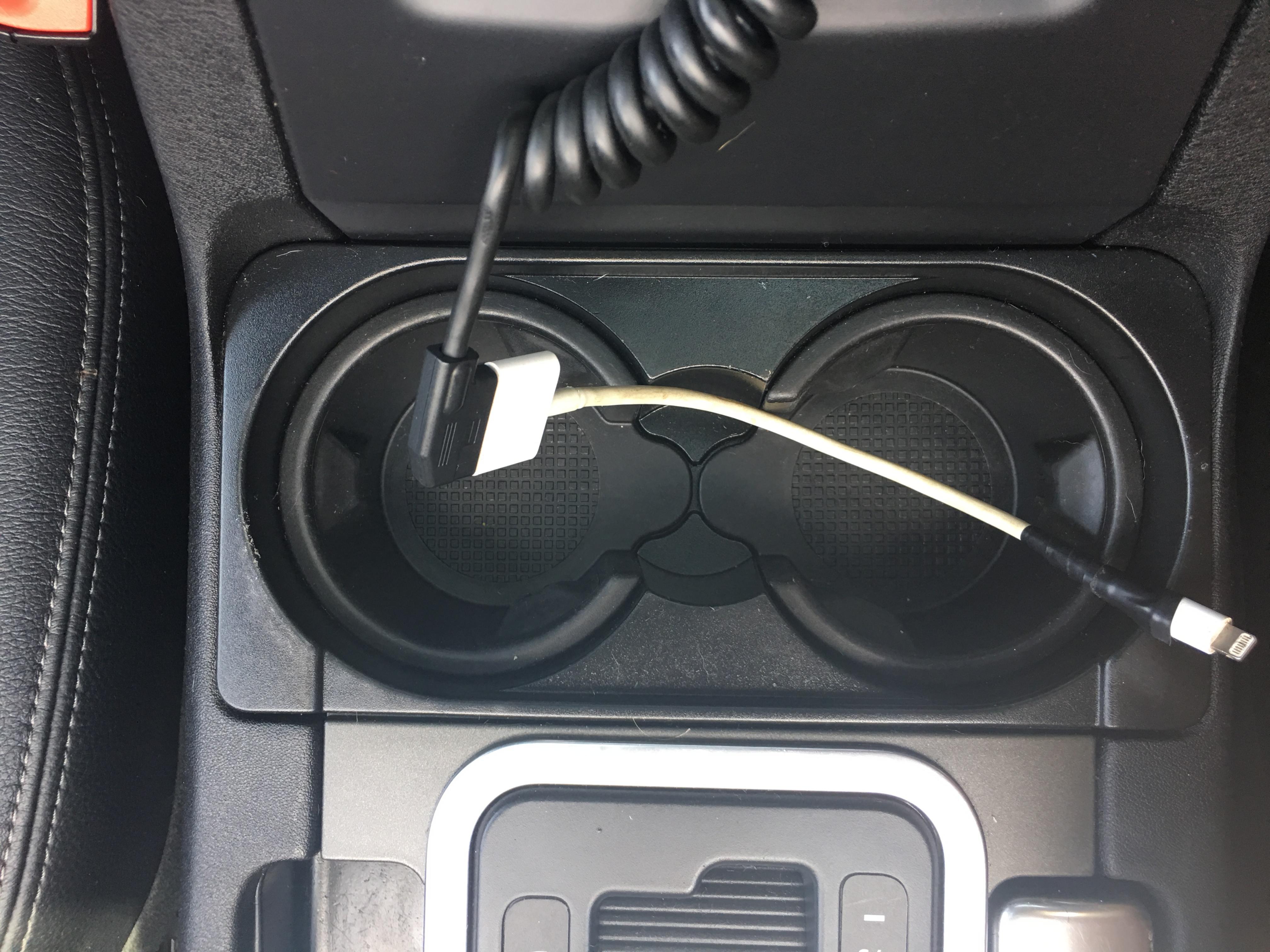

Hey guys. I'm pretty new to this forum. Just bought my LR4 one week ago. I really dig it. I've been buying parts and accessories. In two weeks or so it should be fully equipped.
Anyway, I was looking to add the iPod Interface cable to my car and I couldn't find much info so I wanted to share it.
Plugging the USB with a lightning comes up with a device error, as expected.
I wasn't sure what part number I needed specifically to my car for the iPod Interface Cable. I found someone on eBay selling one that he used in his RRS of the same year. I had my doubts that it may not work in my car but he offered a return in case it did not.
So I used the following:
AH22-19H401-AB (OEM Land Rover)
Lightning Adapter for 30-Pin (OEM Apple)
Everything works perfect on my iPhone 6S Plus. I use my Bluetooth for the phone function. I'm so glad to be rid of the AUX cable. Apart from digital control having that cable dangling from behind the armrest console to the front is annoying and looks terrible.
Very happy.
