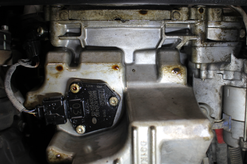

What is the small black cable and plug that sits right behind the engine/transmission joint? Its got three torx screws on it. That seems to be pretty wet.

If you mean what's shown in the photo below, that is the engine oil level sensor, in the oil pan.

Yeah thats it. Don't think that's related then.... Question though, why is the one in this photo so wet?

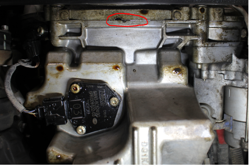

Basically, mine has a drop of coolant collecting right here:
I've got a small oil leak I'm trying to pin down. I cleaned it up and put diapers everywhere. It's been driven less than 400 miles since the cleanup (thanks, COVID) so I'm not sure if there's any visible difference, but I need to remove the panels and see what's going on. I want to pinpoint the leak source before randomly replacing parts.
