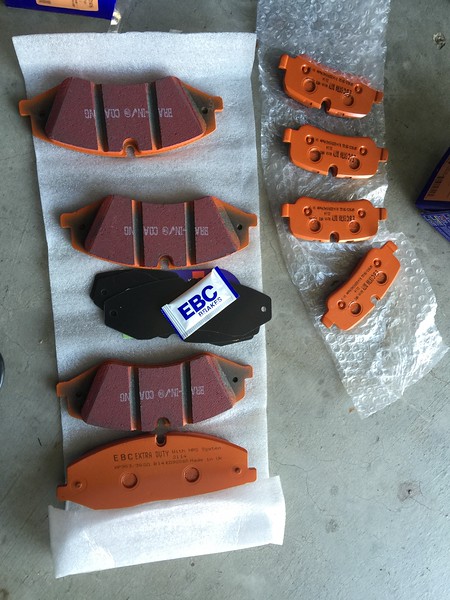

Just ordered these new EBC "Heavy Duty" truck/SUV pads. Anyone have any experience with them or am I the first guinea pig?
I'll probably mount it this week before my next trip to the Sierras.
RBA
May 23, 2010
178
Well, I installed the pads. The EBC rotors had barely any wear on them. Noticeably better than the OEM rotors of approximately the same mileage.
The orange dropped right in, no issues. First impression seems that the pads are grippier than the yellow EBC but time will tell.
RBA, where did you buy these pads? When I input 2012 LR4 into the EBC website it claims these pads aren't available for the make/model.
Thanks in advance!
Thanks in advance!
Strange, I originally found them on JC Whitney. Odd that EBC doesn't even list LR on their shop website. Not sure what to make of that.
The parts I have went in fine and are working great. They do produce more dust then the yellow I had.
