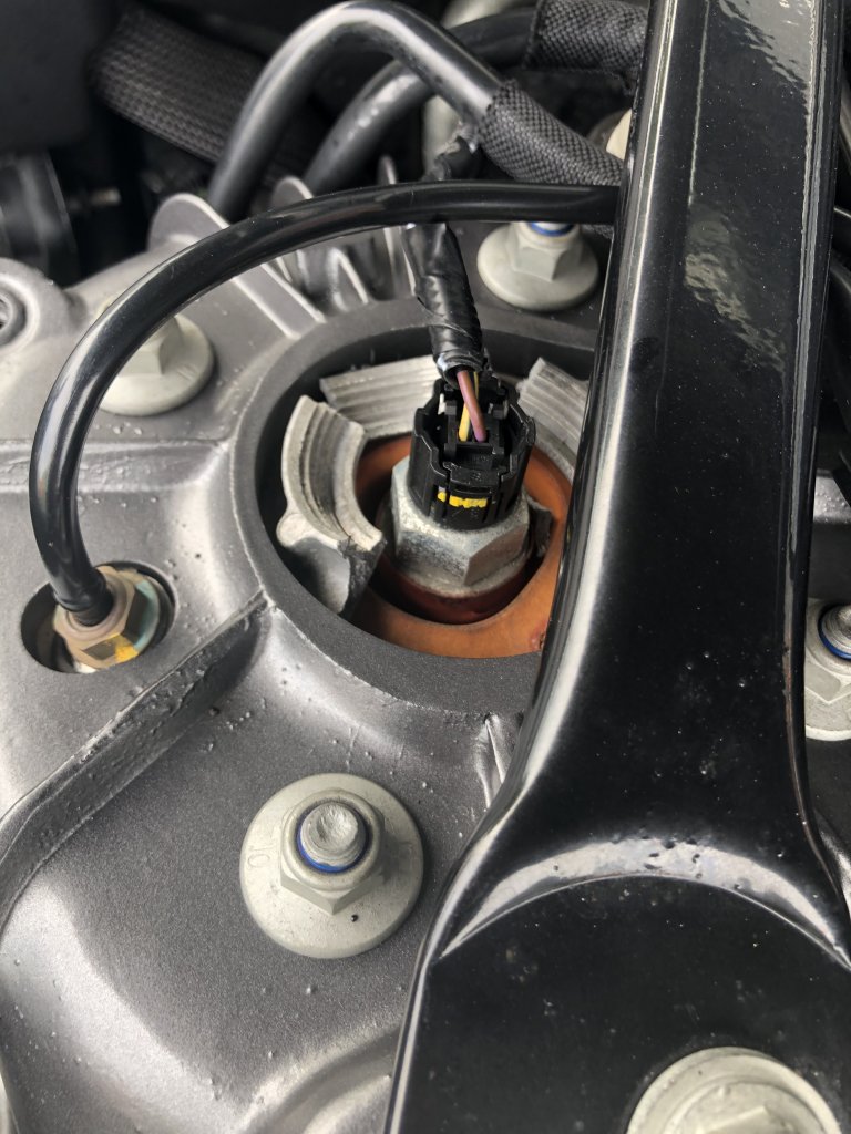

Any idea how this cracked top of the air suspension might have happened?
Does anyone know if this normal ?
Sport HSE SDV - Diesel
3.0 2014. Front Suspension is broken.
Nearside front Air suspension arm pin or bush warn.
