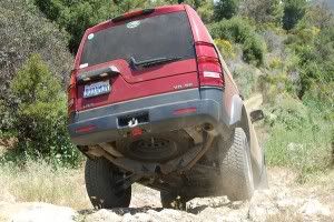

I love that pic with the Goodyear silent armors and the LR3 lift kit. Got it on the website. Drop me a PM with your email. I like this pic going the other way too!

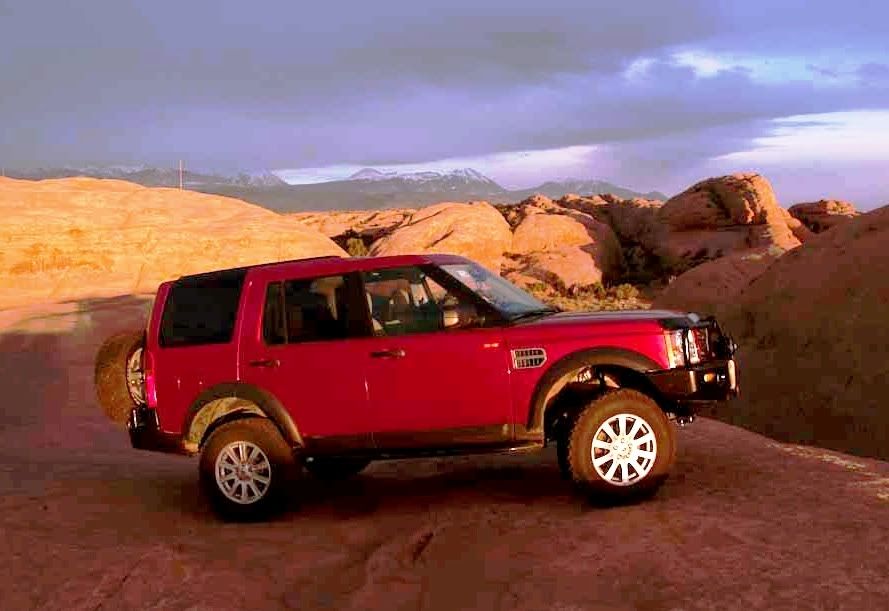

Where do you wheel Johnson? ur in so cal desert ya?
ur red rig looks sick with those GY MTRs! what size!?!?!? guess im gonna be buying rims soon too. du u know if some stamped steels will fit? im going for the mil spec look
Thanks man. Yes, I wheel in the So Cal desert and with SCLR. Not sure on the rims but someone on this forum may know where to get them. Hope to see you at one of the SCLR events.
