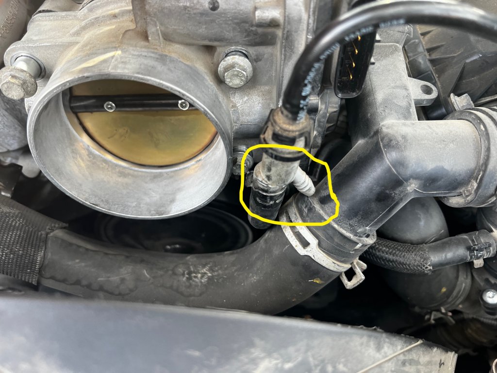

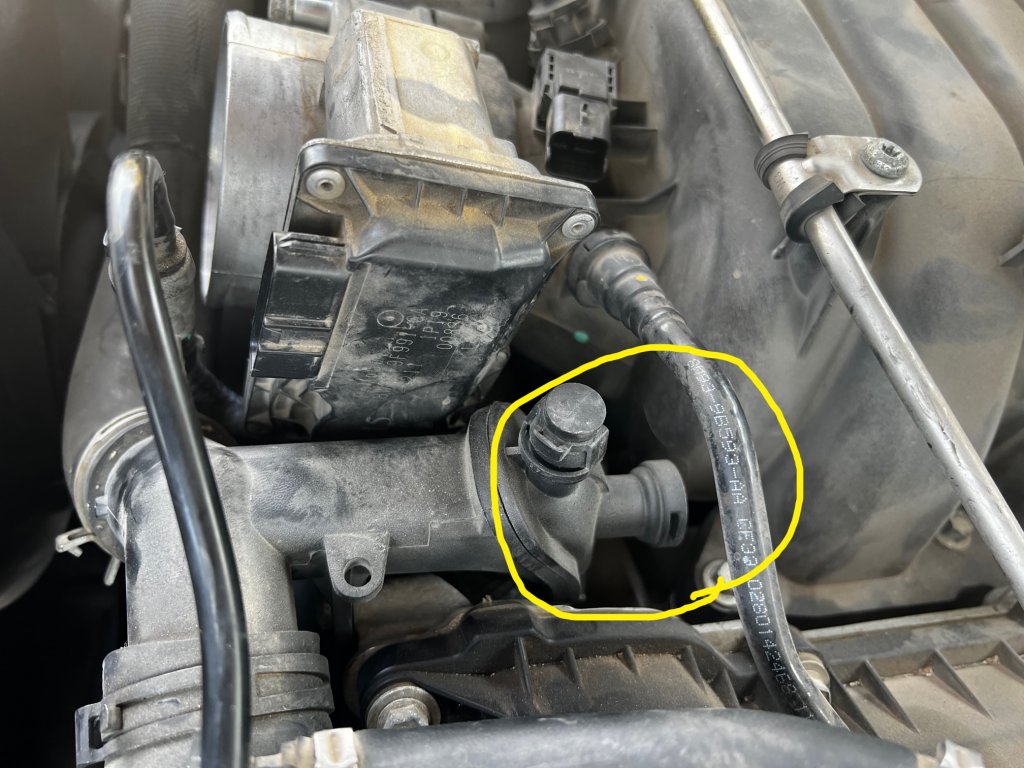

Hi,
Have a 2012 LR4 that has been randomly going into limp mode. If I stop the car and restart it it will usually behave and not go into limp mode again. Lately however it has been going into limp mode pretty much every time I take it out but at random times, sometimes its as I'm stopping and feels like its missing out, other times its when I'm doing 80mph on the highway and it just happens.
The code that throws is P0106, I replaced the Manifold Pressure Sensor and cleaned both MAF Sensors. After reading some solutions on the forums I took intake off to clean the throttle body but noticed that there were two connections that were not connected to anything and didn't know if they were supposed to be?
Don't know if anyone else has had this issue or could tell me about the ports down below.
I had the water pump replaced about a month before it started acting up and going into limp mode so don't know if they forgot to hook them up or if they are supposed to be like this.
here are the pictures of the two ports that are not connected. Don't know if they are bleed offs or what.

Is that an old picture? The throttle body is loose because it isn't bolted down. That would cause a MAF code. Air leaks along either intake channel can cause a MAF code too.
greenmako
May 16, 2022
Salado,Tx
Yea was in the middle of putting it back on after cleaning when I noticed the two ports and wanted pictures of them. Thanks I'll have to see if I find any leaks
