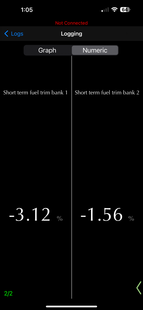

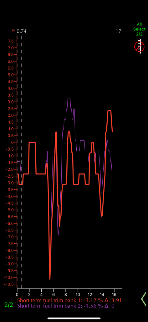

If you have a GAP tool, or any OBD tool that does live data, check your short term fuel trims. If they are high at idle and correct themselves when you Rev the engine, you have a vacuum leak. That can also set a P0106

I have the GAP tool now. Is there a place to look up what normal fuel trim reading should be? Or any other diagnostics I should be checking? The MAF's are factory and originals as far as I know but would expect them to throw codes if they were the problem.

Fuel trims are ideally 0, but +/- 10% is considered normal. That’s at idle. I’d look there first.

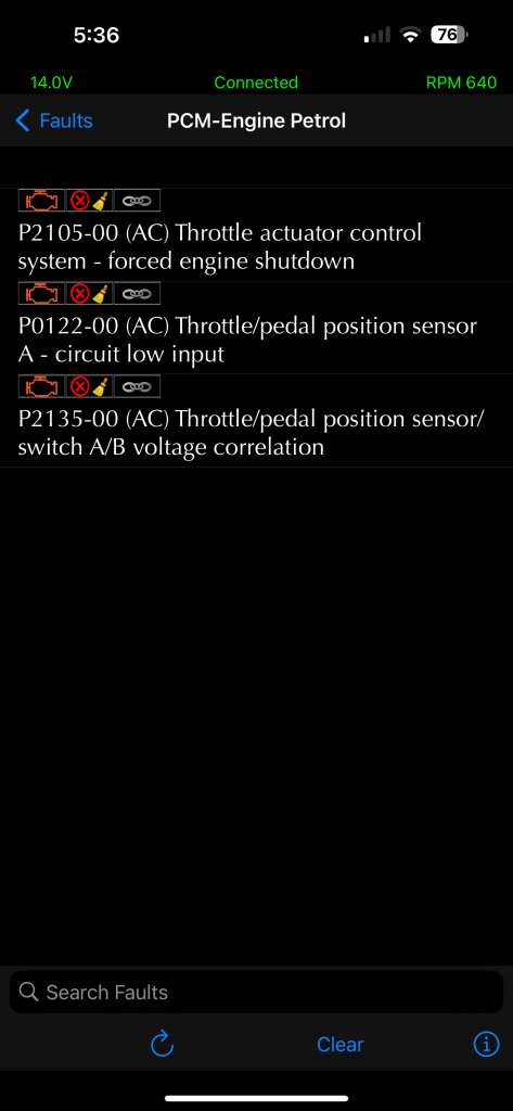

Its throwing new codes now:

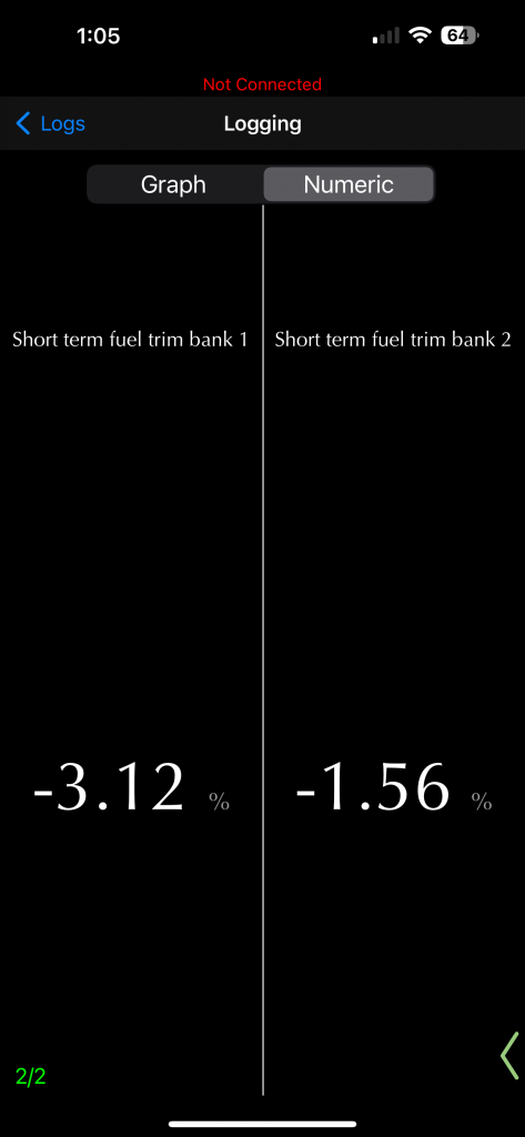

Took reading of the fuel banks
Here is idle:
here is a run where I rev'd to 1500 rpm's for a short bit
