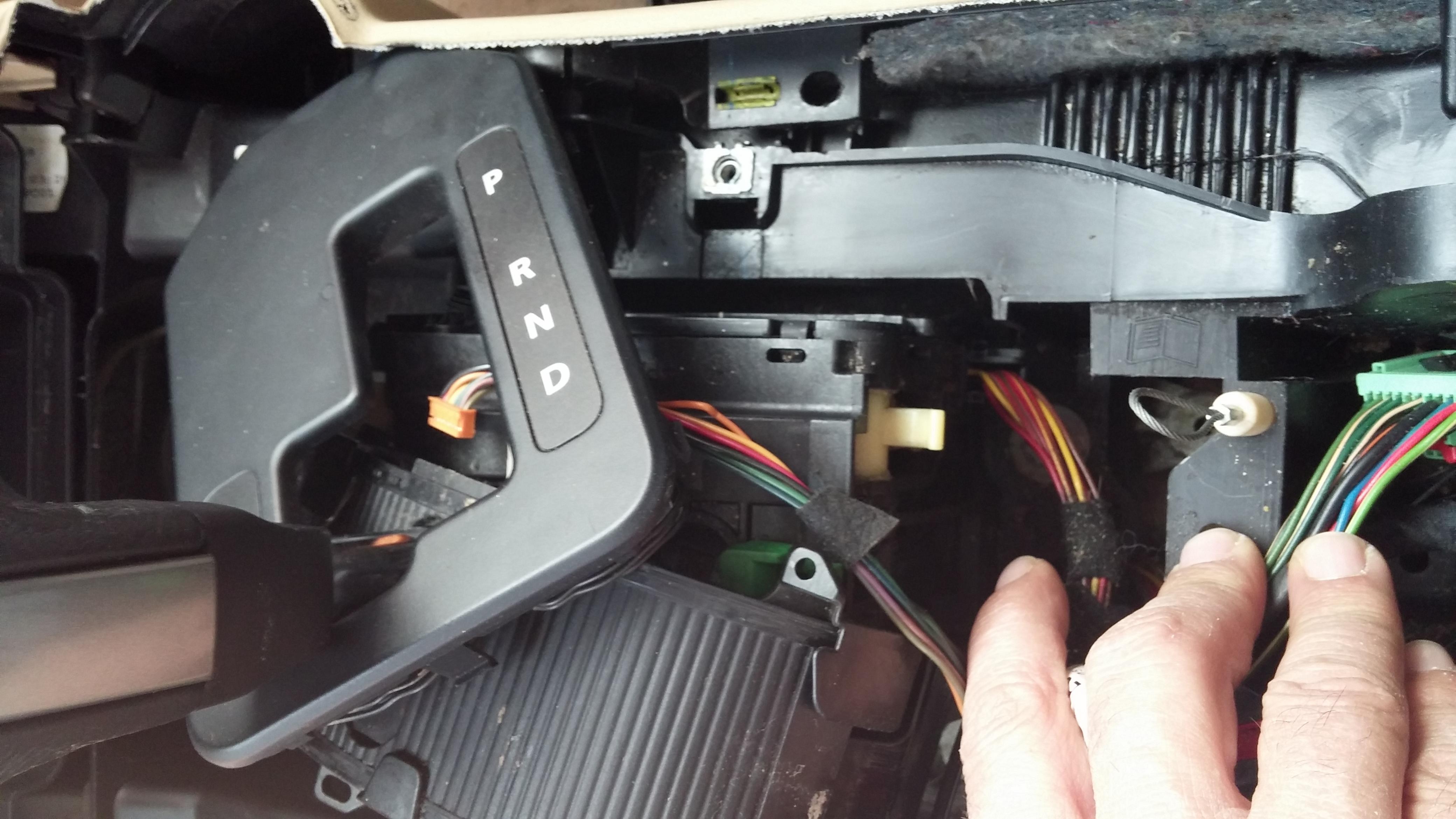

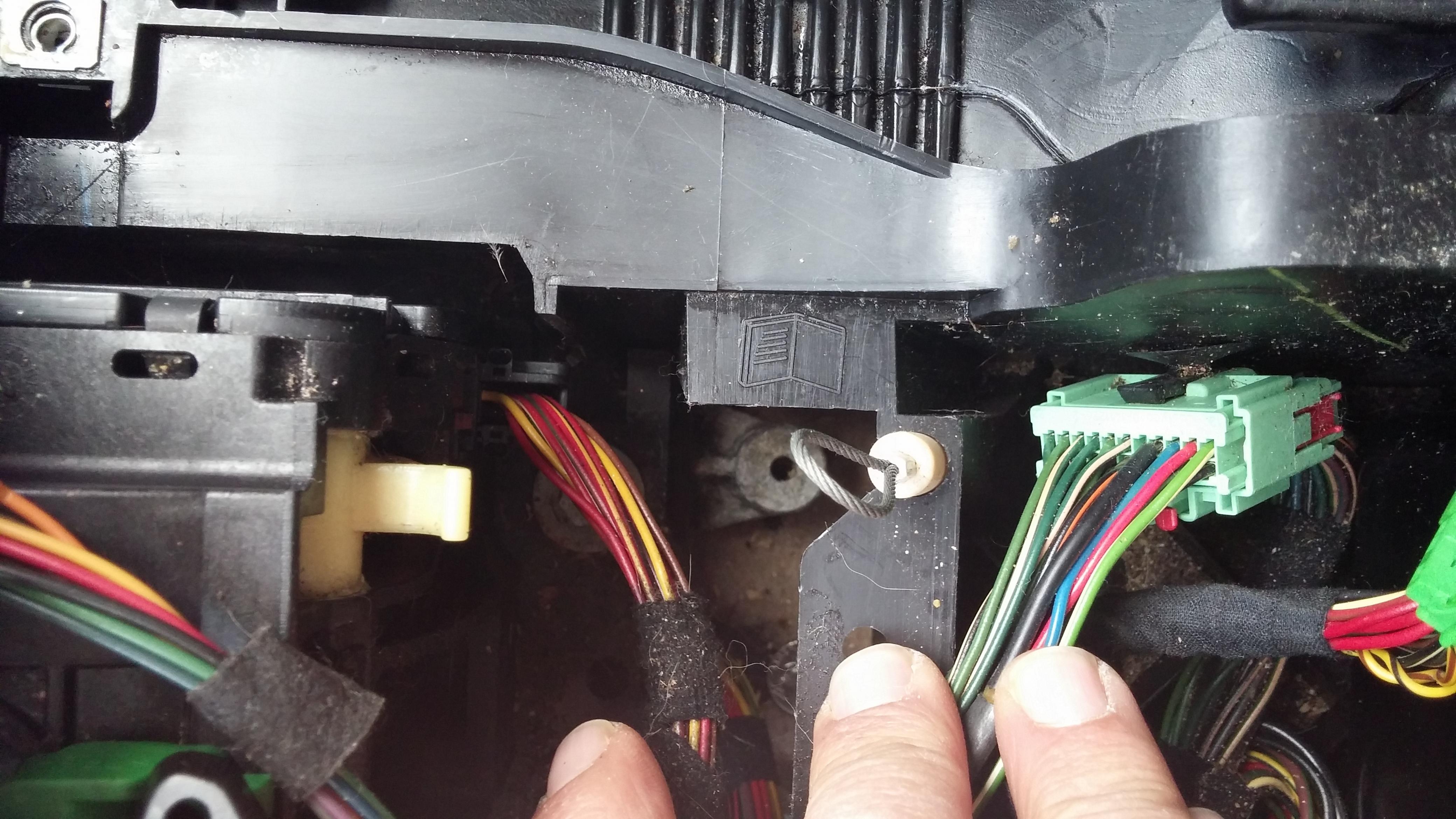

Can anyone help me out here. There is a yellow based plastic piece with a wire looped into it underneath my middle console. If you remove the consol to look at the gear shift (automatic) there it is with a picture of a book to the right of it. I have attached pictures.

That is the manual release for the parking brake, for when the electric one fails.

Didn't even know that was there. Is it easy to access?

The instructions are in the owners manual. There is a small access panel you can pry out of the bottom of the right side "pencil holder" cubby you can then find the loop with a flashlight and a screwdriver. Slip the screwdriver through the loop and use it to pull the cable up to release the brake. Depending on how the truck is sitting it can be very difficult to pull since the brake is holding 3.5 tons on a hill.
