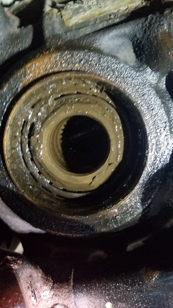

So when the cv axle (half shaft) is replaced, does anything have to be greased? When I took the seal off the diff, it looked like it was packed with grease. The diff oil was very dirty so I guess it could've been built up sludge. If it needs to be greased, what should I use?

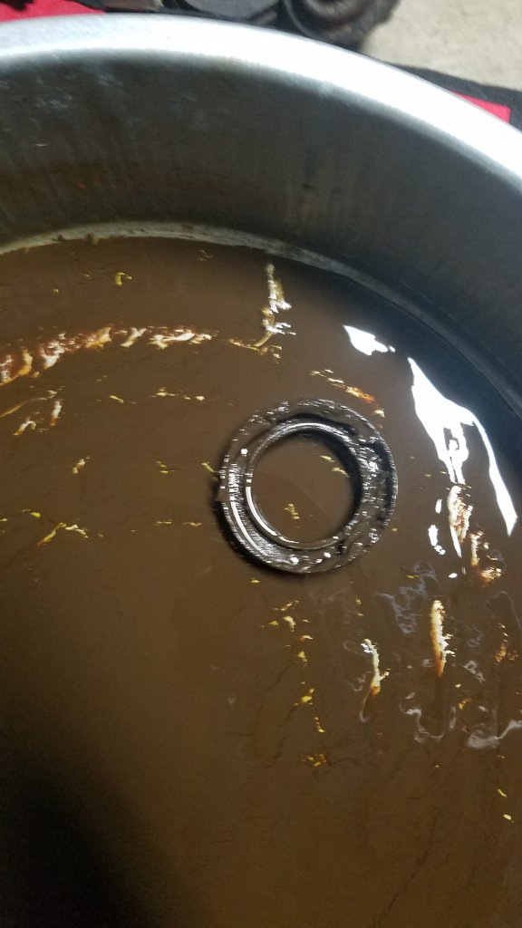

The second picture is the diff oil I drained and the cv axle seal on the diff. The seal looked like it was in really good condition but I replaced anyways as suggested from guys here. I'm going to change the diff oil twice or more.

Nothing broke on mine but the oil is very dirty. I think if it's just leaking it shouldn't cost very much. The seals are about $20 for each side but not sure about the main diff gasket. I used royal purple max gear oil which was $96 for 6 qts. I got extra so I could change the front and rear diffs twice cuz it's so dirty. It might be a little late but I'm going to start changing my diff oil every 30k miles now. Diff rebuild kit is about $400
